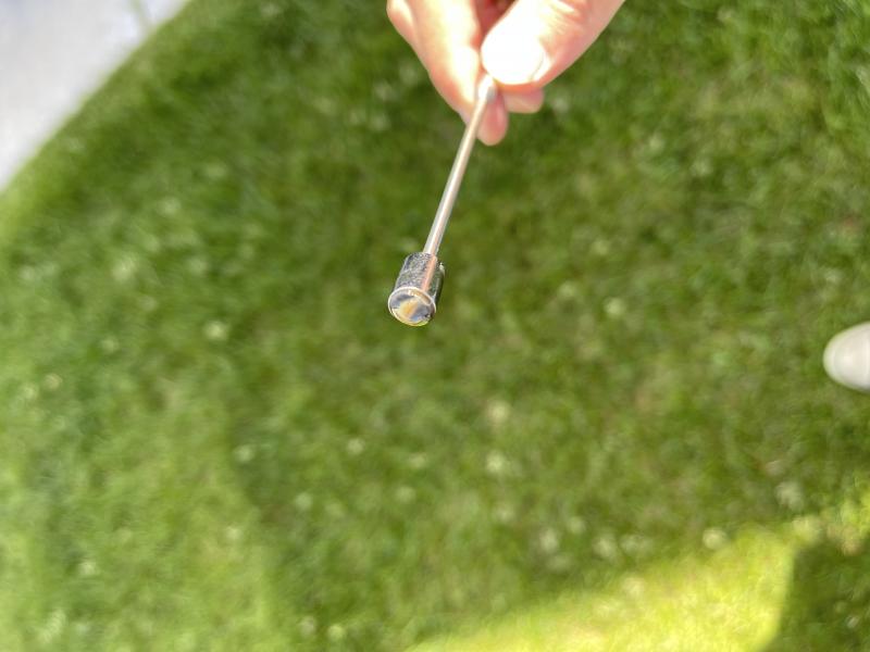

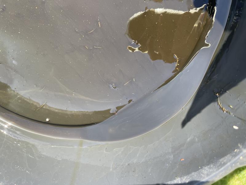

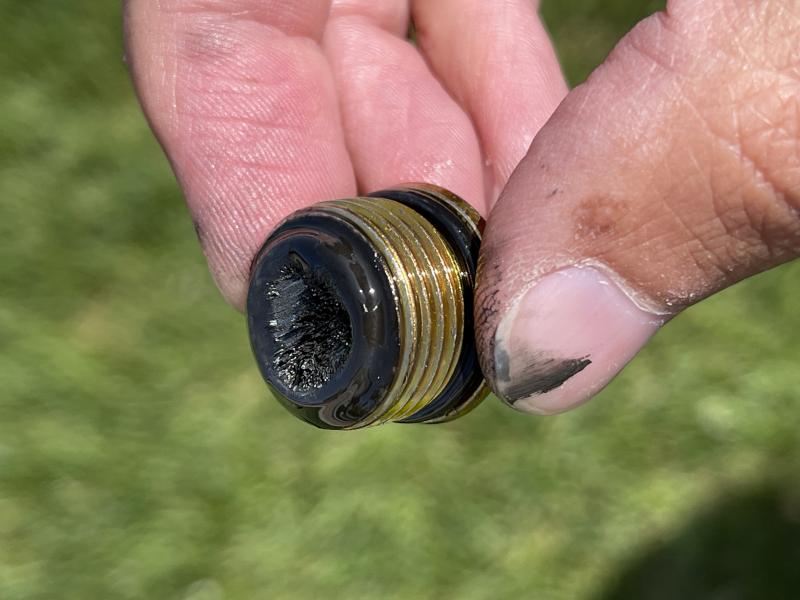

Pictures attached. I found ferrous material everywhere in the oil. Much of the oil had a consistency similar to molly lube. Anywhere I put a magnet I got metal.

I don’t know but that high pitched growl sounds more like it started to locked up a needle bearing on one or more of the roller lifters.
Having a crank bearing fail and driving it home it would make a knock, and the shavings probably wouldn’t be sticking to the magnet like described, many of the filings found would be nonferrous.

That is possible. These lifters have always been loud, so I've somewhat learned to ignore them as they've been checked annually or bi-annually at the least and never never shown signs of having an issue. But it's a known problem area of course.

Oil level was good. The engine doesn't consume oil and doesn't leak. I drained a full 6 quarts.

Since there’s now been a good amount of grit flowing around in the motor once your tare it down inspect the piston skirts for imbedded grit and of course scratches.
Also pull the oil galley plugs so a hot tank session will remove any hung up grit that might be hiding in there, especially if there’s old sludge in there.
Be sure to take the oil pump apart and check for scratches on the pump cover and gears and double check the bypass chamber for grit.
