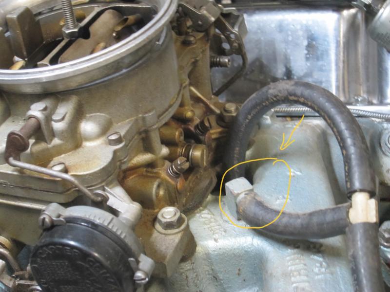

Where is the best place to get the vacuum for reading on my vacuum gauge?
Yellow Banana 08-24-2024 03:04 PM
I believe you could hook into this for full vacuum Attachment 638825
Or you could hook into that hose on the rear to the brake booster.
arbys 08-24-2024 03:09 PM
It would have to be the first mentioned. I have manual brakes.
Yellow Banana 08-24-2024 03:14 PM
Well, there should be a large port on the carb rear that is probably capped. Near the base.
Kenth 08-24-2024 03:42 PM
I would "T" into the distributor vacuum advance hose.
