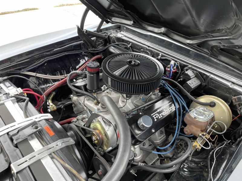

JLMounce 09-17-2024 09:32 AM
Here’s a picture of the engine bay. You can see the straps that hold the upper fan.
They are just unsightly.
So it sounds like that top u-channel might be okay?
Attachment 640093
78w72 09-17-2024 09:54 AM
Dont they make trim/mounting panels for use with electric fans? Or Ive seen the fans mounted to teh radiator itself without any additional brackets like in your pic... doesnt cold case offer a set up like that? I know other companies have a set up to mount the fans to the radiator without external straps or brackets.
jwcfbd 09-17-2024 10:06 AM
Does the stock shroud not fit or are you using electric fans? Mine is also a Cold Case and you can see where the top panel is only tack welded to the tank it's not a complete weld. I would think you're safe to use a short screw but need to be very careful not to go to far. Less than a 1/2" . I would also remove the stock bracket if you're not using it. You could all so call the manufacturer and see if they can answer for sure.
