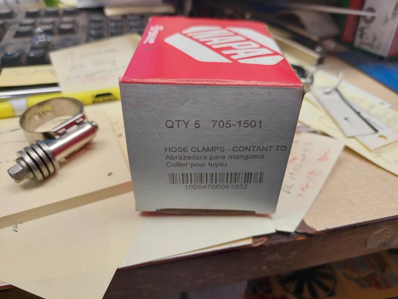

77 TRASHCAN 09-24-2024 10:06 PM
Attachment 640463
77 TRASHCAN 09-24-2024 10:09 PM
Attachment 640464
