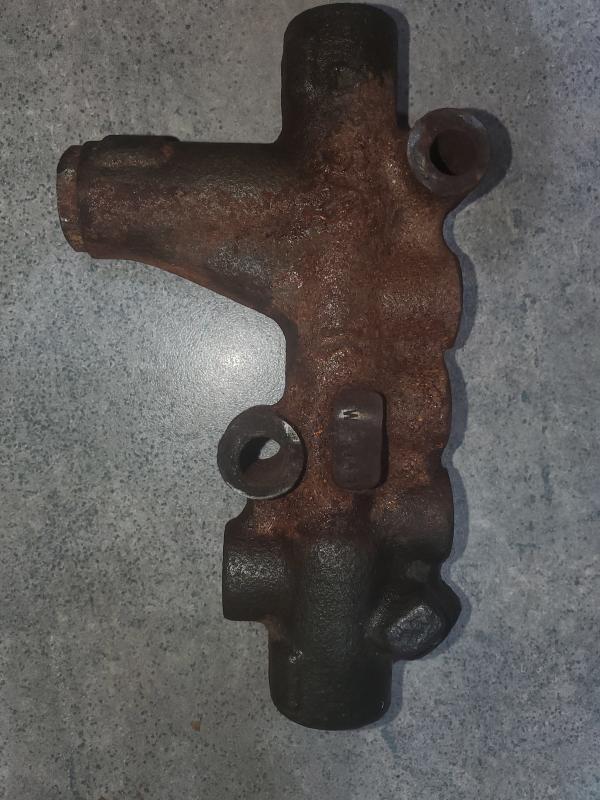

The whole system is new except the proportioning valve. I pulled it apart, cleaned, and replaced the o-rings. I still wasn't getting fluid out of the rear line so pulled apart again. I found the rear portion with the heavy spring was still rusted together, first time I thought it one piece. I guess what I'm asking for is a fluid path through the thing. The fronts are easy enough to see how it goes, the rear portion seems like the spring isn't really doing anything.
I have the calipers adjusted with parking cables on. I have fluid at the back, but with the bleeder open, I barely get any fluid out, and the pedal is super stiff. Master cylinder is smooth and works easy, and is bleed out.
I will reinstall the proportioning valve now that the spring and valve are free to move and see what happens. Pretty sure I can't find a rebuild kit for the valve, so a new one may be coming. If I can get fluid through it, pretty sure the brakes will work like they are suppose to.

Heres where it is now, waiting on new seals. Pretty sure the proportioning valve was holding up the fluid, it was rusted in the hex nut not letting it open enough. I will know once I get new o-rings and seal in place and back on the car.

The one I rebuilt is on the car and working now. It's still in the paint process so no drive time. I found the portion going to the rear was rusted in place not letting any fluid through, top of the picture, the silver shaft with lip seal was stuck. After the cleaning and new seals it was still hard to bleed the system. I had a hold off tool, but it didn't help much. What I did was fabricate a 1/4" thick clear plastic lid with a threaded hole to fit over the master cylinder with a cork gasket. I had a fitting for a vacuum line threaded into the hole. Using my truck as a vacuum source with a long hose, I put the end of the hose up to the fitting but not over it. The vacuum was enough to pull some air out of the rear system, I did it a several times and each time it would pull more air. Too much vacuum will pull air in through the caliper seals, so I was careful with the hose. The vacuum worked so well because the proportioning valve is designed to not let fluid to the rear brakes till the fronts have started to work, by pulling the fluid backwards, there was no restriction and the air came right out. Another '79 owner called about his brakes, so I explained how I bleed them. He did his the same way and in just a few minutes had a solid pedal using the vacuum method.
