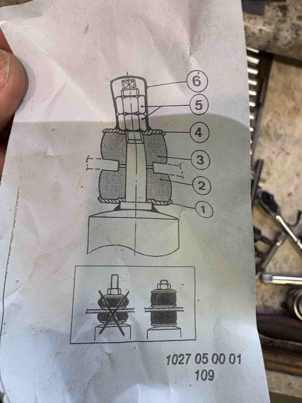

fairwayhit 12-01-2024 12:52 PM
Well I’m 99% sure that the rekudo shocks are Koni red shocks just painted gray. Reason I say that is they are adjustable (same as koni) they are made in the Netherlands, the tops have the exact same little cap that covers the stud, and the instructions have the numbers 1027 05 00 01 109 on the bottom. When you google that up, the 1027 thing is a koni identifier
I haven’t got my car running so I can’t comment on the ride, but I thought I would share since they are $29 each on Amazon and if I’m right that’s a heck of a deal. Thought I would offer that info up in case it helps someone. There is almost no information out there on the inter web. No reviews etc.
I’m not affiliated with koni, Amazon, Holley, etc so buy them at your own risk. Just wanted to pass on what I found.
