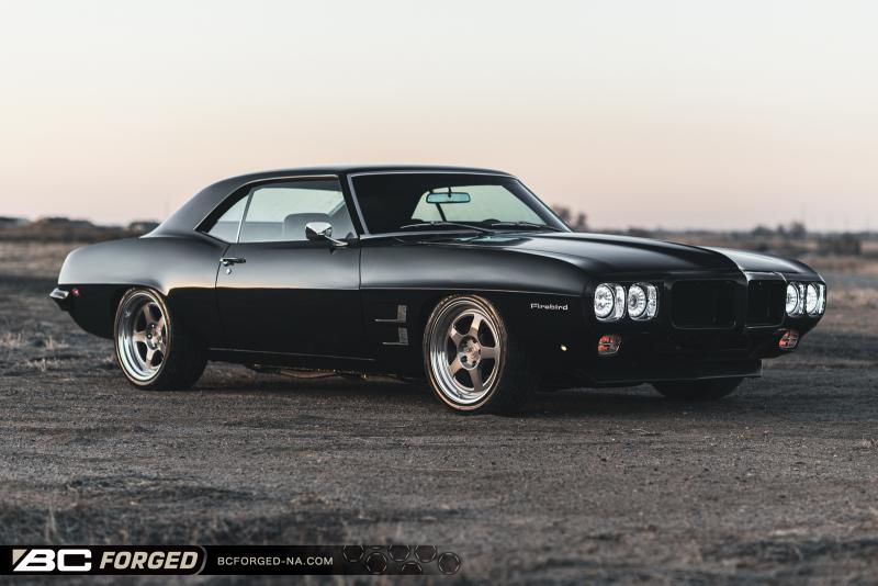

JLMounce 02-14-2025 04:33 PM
2 Attachment(s)
I think the panel style LED's regardless of brand will work well with the aesthetic of the car.
Attachment 647506
Attachment 647507
