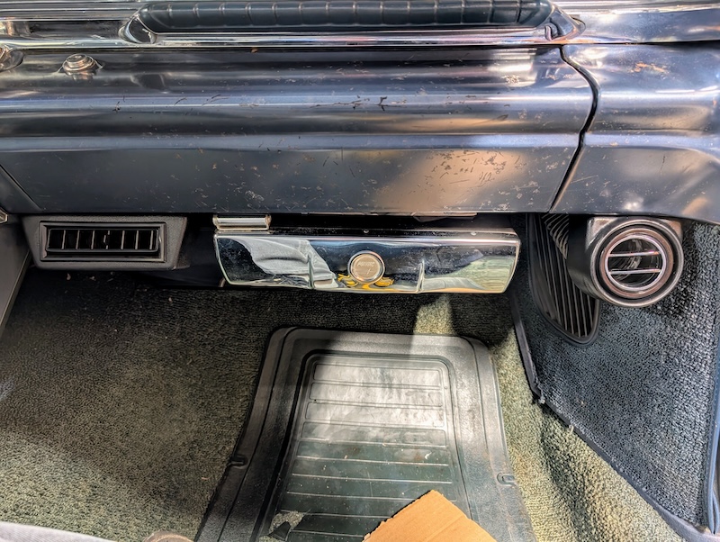

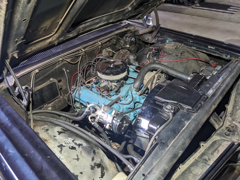

I have a setup close to this. I have aftermarket air added to my '64 GP, so it should be pretty similar. I went with Vintage Air because they were willing to work with my shop on creating the custom mounting parts needed. I added an aftermarket fan shroud to make sure it stays cool if traffic is crawling.

However, my car didn't offer factory air. So we added some vents under the dash that fit around the tissue dispenser and some controls/vents on the driver's side. It's functional.
Like you mention, they basically had to delete the glove box and install the blower behind it. They also got rid of the heat exchanger because that wasn't necessary anymore. The A/C that they give you is just reversable a heat pump. So it can switch between heating and cooling the cabin.
If you look under the glove box, you can see the blower motor box sticking out a bit. I think we also closed off the passenger vent cowl. But it doesn't feel like there's any less leg room. This is a long car.
Attachment 648458
My end-goal was to make sure this was a car I wanted to drive when it was nice a sunny. The A/C helps with that decision during hot weather.

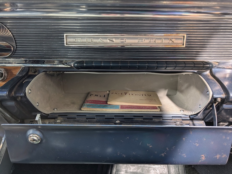

Bagel 03-11-2025 10:59 PM
2 Attachment(s)
Thanks to @Goatracer1 that mentioned there were A/C specific glove boxes. I had no idea!
Anyway, I ordered a reproduction A/C glovebox liner for the '64 Grand Prix and it fits! I have a functional glovebox again. :D
Here are some pictures with the before and after.
Attachment 648793
Attachment 648794
Goatracer1 03-11-2025 11:17 PM
Glad I could help. It's nice when people with shared interests can be of help.
