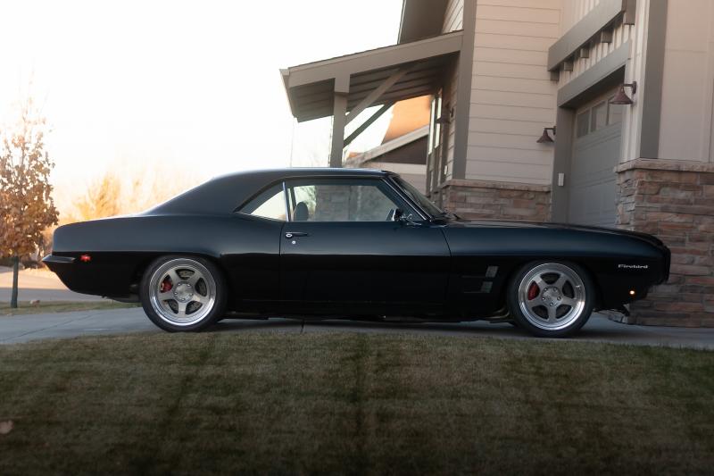

JLMounce 05-02-2025 11:20 PM
Oh yeah, my car is functionally lower than that...by a lot.
I can put a 255 on this wheel though, I just like a little bit of stretch on the tire to help turn in feel.
Attachment 651160
65madgoat 05-02-2025 11:46 PM
Yeah that is low. I gave up going a half inch lower so I can drive everywhere with no issues.
JLMounce 05-02-2025 11:53 PM
I actually don't scrape everywhere I go. I don't even really have to worry about how I drive the car. This angle makes it look worse than it is because the car is straddling a fairly sharp bend in my driveway.
The front wheels rub the large inner fender washer at full lock, that's about it.
