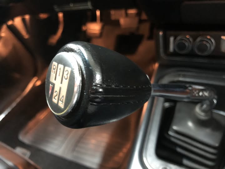

71GP76TA 06-23-2025 08:26 PM
My 72's
Attachment 653342
65madgoat 06-23-2025 10:10 PM
Yes perfect. Thanks 71GP76TA!
My guess is that this style like on your 1972 was original on 1971-1973 (maybe to 1974?) and then the other raised lucite emblem (but without the recessed ridge below showing like in your photo) was from after 1974 to 1976 or so --- and maybe to 1978?
