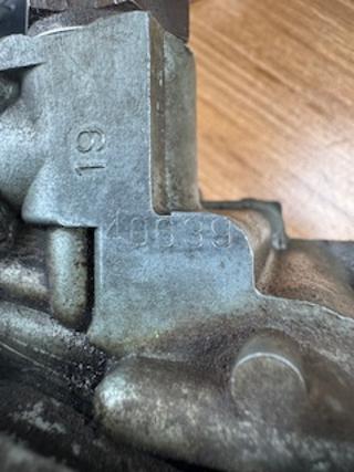

2 Attachment(s)
Hopefully, pictures requested! I see a 19 or a 61 on the inlet boss. Guess it is a 19. Please LMK. Thanks!
"Bill"!
Kenth 07-06-2025 04:19 AM
19 is correct. Need to see this number inside the yellow marking.
Throttle plate looks ok, need to check the size of off-idle slots above the idle needle holes.

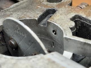

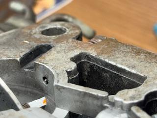

2 Attachment(s)
The off-idle ports/slots on a RamAir Qjet throttle plate are shorter than on a non-RamAir Qjet.
Shorter off-idle slots above the throttle blades at idle speeds equals richer idle mixture.
Did you check the fine stamped number within the yellow ring?

bill ryder 07-13-2025 01:38 PM
4 Attachment(s)
Attachment 654270
Attachment 654271
Attachment 654273
Attachment 654275Kenth, here are the pictures you requested. Thank you!!!
bill
Kenth 07-14-2025 08:10 AM
4 Attachment(s)
Bill, the off-idle ports on your throttle plate has the correct size for a 1970 RA unit.
So, you have the correct float bowl and throttle plate, unfortunately with an added side vacuum port and the airhorn, choke pull-off and fast idle cam are wrong for this carb.
