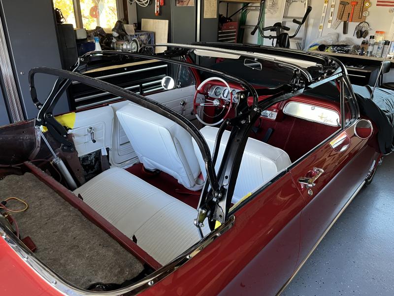

I’ve also used Eastwood’s 2K rattle can paint, on a convertible top frame for a Corvair. Thought it went on really well and dried hard. It was the one where you push the button on the bottom of the can to mix the material and then you have ~48 hrs to use the can. Probably as close to using a gun as you can get from a rattle can as far as finished product.
