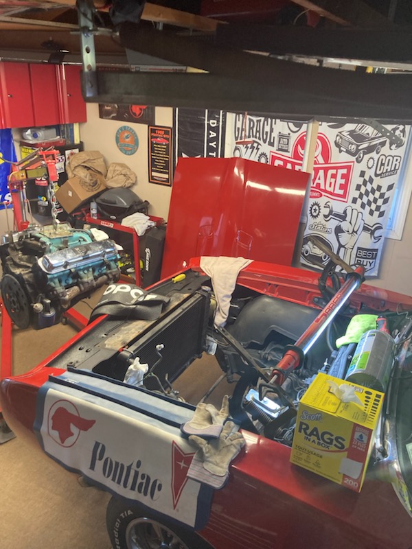

1969GTO 09-27-2025 02:42 PM
bracket
You are the 68 GTO man.
That makes sense, I did remove the stock [cracked] manifolds and the valve was frozen open.
Time to order Ram Air exhaust manifolds.
thank you for the info.
Attachment 657813

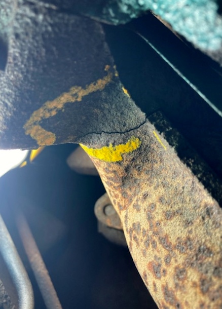

I wonder if the manifold cracking in that area was also a reason to discontinue the heat riser? Mine was cracked at 45000 miles or earlier.
1969GTO 09-28-2025 08:55 PM
cracked
Attachment 657907
