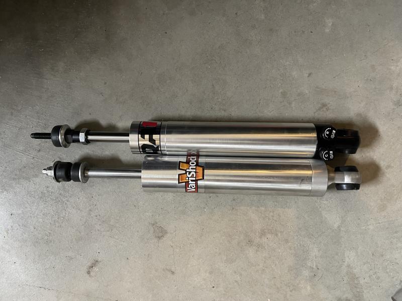

Coming back to this part of my original post. The reason I was having issues with some bouncing was not an issue with the amount of rebound damping I was putting into the shocks.
Plain and simple, the QA1 shock was too long for my application. Double checked my shock ride heights and I was just bottoming out the passenger side shock. Not enough that it was causing crashing harshness, but just enough to compress the bushings in the stem and lower mount and likely using the tire a bit as well. All this became an un-damped spring of its own and was causing the bouncing.
To verify, I threw my set of non-adjustable Verishock's back on the rear and instantly the ride cleaned up. No bouncing, just a controlled spring without a lot of bouncing. I will say that the non-adjustable Verishock, is a little underdamped for this spring. It could use a bit more compression and a slight bit more rebound.
I'm attaching a couple photos to give you an idea of what's going on here. The QA1 shock I still think is a good high quality twin tube, but it's built to be modular to keep SKU's down and pad QA1's bottom line over having 1000's of different SKU's. Because of how they attach a stem mount for bushings, you actually lose about 1.5" of the effective shock travel. But QA1 still has you measure from the underside of the bottom bushing.
In my case, with the TD802, on the passenger side specifically that stem mount is enough to run out of compression distance on the shock. Even going to the TD703 which is nominally 1" shorter, I would only gain enough shock travel in bump to leave maybe 1/4" of room. Too close for comfort on some of the roads around here.
So for now the Verishocks are staying in the back. Most people are not a proponent of mixing and matching shock brands, but in this case, QA1 doesn't appear to even make a shock the length I need it for my application.
For Global West's part, they have been good to work with, but are baffled at the situation. This really isn't some crazy exotic setup. They sell hundreds of these springs and shock combos and neither I, nor they have an explanation on why shock ride heights on my car are coming in so short.
The Verishock line is about an inch shorter in the shock body itself and doesn't have that screw on stem mount that is taking up more shock travel. For leaf spring cars that get low in the rear, it's sized more appropriately. Likely a benefit of it being a mono tube vs twin tube shock.
Attachment 659816
Attachment 659817

Yeah the 72's are going to be slightly different of course. When installing, check how much exposed shaft length you have at ride height. You'll likely want a minimum of 2.5" of exposed shaft (not including the stem mount).
I think they spec the same TD802 that I have for the 2nd gens as well. I did speak with QA1 and they said no issue with mixing and matching their part numbers. So you could do a shorter TD703 on one side if you need to.
If the car is on the ground now, you should also measure your shock ride height before install. Measure from the center of the bottom eye to the bottom of the lower bushing mount while the car is at ride height. For the TD802 you need to be in the 15.5-16.5" range. If you're outside of that you may want to look at a longer or shorter shock as necessary. Obviously it's easier to sell stuff that's new in box vs stuff that's been mounted already.

Yup, notice the difference in ride height. The TD801 is very close to the 802 I have in total lengths.
Staggered shocks on the first gen, so ride heights aren't exactly the same. 14.750" passenger, 15.5" driver. Much too short for that shock, specifically on the passenger side. Driver's side was fine. The TD703 may work on the passenger side, but it doesn't leave all that much more room. This is why I'm heavily leaning towards another verishock in the rear. My thinking is that the car/spring itself doesn't know what shock is attached to it, and if I'm putting a double adjustable on there, I can still give the spring the damping it needs.
I'd hate to buy another single shock from QA1 only to have it still not be short enough.
