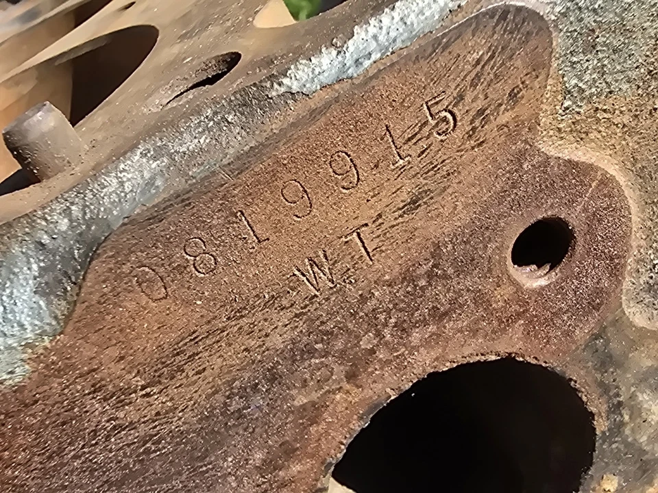

8453johng 11-10-2025 10:46 PM
Earliest 1970 Block ??
There is an ad on e pay showing a block calling it a late 69
But the WT block is stamped 70
The question is the block shows F 19 9 June 19th 1969
This is one of the earliest block I've seen for 1970 gto
9799914 to me definitely a 70 block
Here is the ad cant figure how to upload
1969 Pontiac GTO 400 4 spd WT Engine Block 48 Heads 1111970 Distributor 69
Baron Von Zeppelin 11-11-2025 02:25 AM
I will try to find it and give it a once over.
The EUN - if high number - means it's a late1969 model.
EUN - if low - means it's an early 1970 model.
A legible stamped VIN would identify it also.
Motor mount bracket bosses another indicator.
They started using that casting around May of 69 , with 70 cast in raised numbers by distributor.
Baron Von Zeppelin 11-11-2025 03:04 AM
It is a late 69 WT block with somewhat close dated #48 heads - E229
The high EUN 0819915 determines it for sure.
It was the 819,915th engine produced for 1969 model year.
70 model use that early would have a very very low EUN

OG68 11-11-2025 03:26 AM
There's a 9799914 block on the Wallace EUN search page that was cast in March of '69
