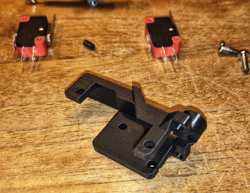

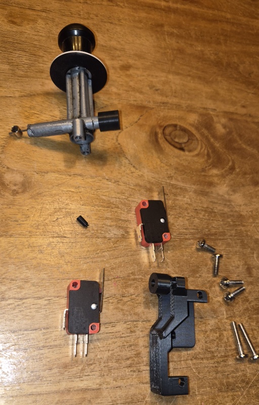

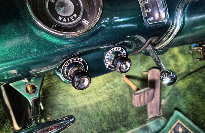

While working a little bit further on the electrics, I am replacing ugly extra switches installed by the preowner. Two of the switches were for the electric wiper motor and the washer pump. Luckily I got the original wiper switch of the original vacuum wipermotor along with the car. I really want to keep the original look, so I thought of how to use the original vaccum switch for the electric wipers. So I constructed and 3D printed a holder for two small electric switches which fit plug&play to the original switch. After a few tries and few wasted prints it works now as a charm:
These are the parts, the 3d printed holder and the two electric switches. The small pin extends the washer button, the black cap on the original switch I also printed is just for dirt protection:
https://golf1wiki.de/downloads/ponti...schalter-0.jpghttps://golf1wiki.de/downloads/ponti...schalter-1.jpg
Installed switch, original look:
https://golf1wiki.de/downloads/ponti...schalter-2.jpg
I also printed some switch plates as you can see, dunno if I keep them, just a small look&feel experiment :)
I also made a small video where you can see how it works. The holder fits to the original screw holes on the switch:
-->>> Original wiper switch for use with electric wiper motor <<<--
If anyone is interested I can provide the 3d printfiles and also a link to the switches on Amzn.

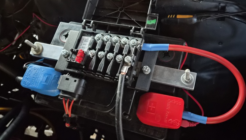

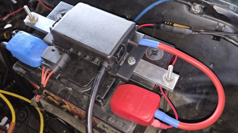

Under the hood I also got new battery cables, reworked the groundcontacts and installed an extra fusebox on the battery:
https://golf1wiki.de/downloads/pontiac/battfuse-0.jpghttps://golf1wiki.de/downloads/pontiac/battfuse-1.jpg
Lights are brighter and the car starts also better already, I can now measure 0 ohms of resistance from the battery minus to the engine and car body :)

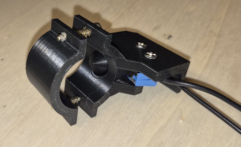

Onestone 12-09-2025 09:53 AM

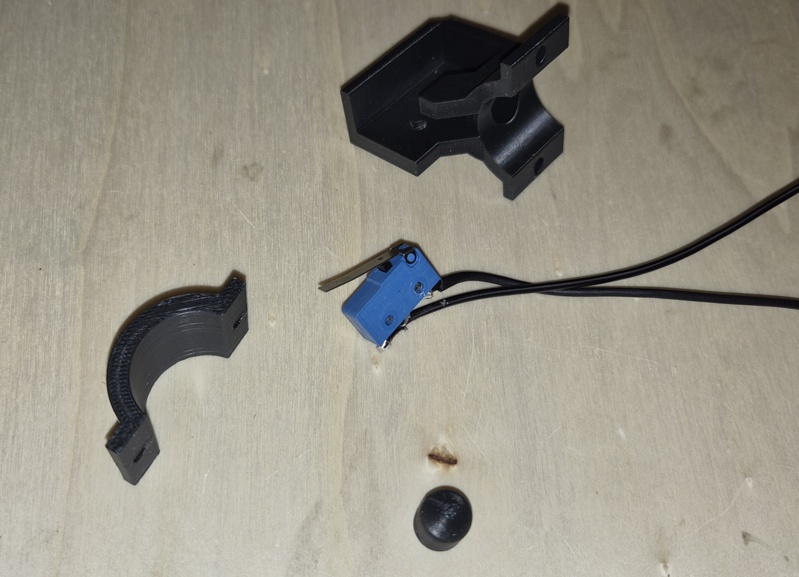

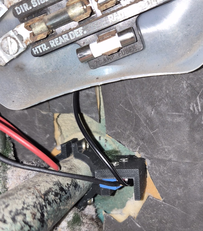

Another small update here: I could nowhere find how the original switch at the base of the parking brake looks, so I designed another replica to make it work again:
These are the parts, its a 2-part holder, a micro switch and a little cylinder to push the microswitch:
https://golf1wiki.de/downloads/pontiac/parkbrake1.jpg
Everything assembled together:
https://golf1wiki.de/downloads/pontiac/parkbrake2.jpg
And installed:
https://golf1wiki.de/downloads/pontiac/parkbrake3.jpg
Works like a charm. If anyone wants to have the 3D-Print files to make one yourself, just send me a message.

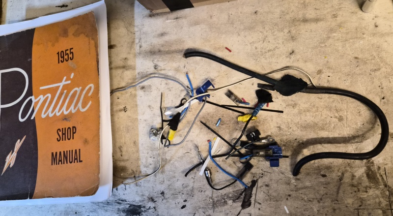

At the moment I replace every cable which is botched. Usually such an evening ends like this:
https://golf1wiki.de/downloads/pontiac/electrics2.jpg
I can't count how many of these insulting tapes, rubber caps and electricity thieves I've thrown away :D

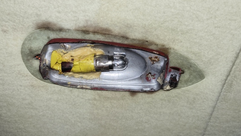

Last night I checked the dome light which isn't working too, and one more time I just thought "WHYYYYY :confused:" :gag:
https://golf1wiki.de/downloads/pontiac/electrics1.jpg
To be continued...

Hi Parkman,
just send me a private message with your email, I will send you the 3D-print files.
Or maybe Safari Larry can put the files on his great webpage ;) ?
My switch is the same as yours, I also have the combined wiper/washer switch as you can see in the video. It just looks different on the pictures, because I have already removed the backside of the switch. If you loosen the two small screws on the backside and remove the vacuum part it will look exactly as on my pictures, see attachment what I mean.
