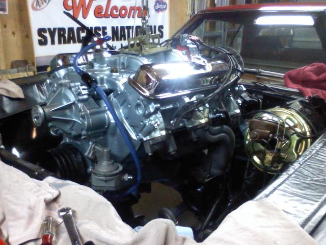

1969GTO 03-17-2026 01:18 PM
engine remove
set chain in the middle of the plate and the engine will lift straight up, just clear the trans.
Attachment 666445
