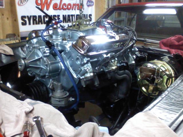

1969GTO 03-17-2026 01:13 PM
manifolds
No problem installing in my 69 GTO and will do the same in my 68 GTO,
My manifolds were/are RamAir Restoration manifolds.
