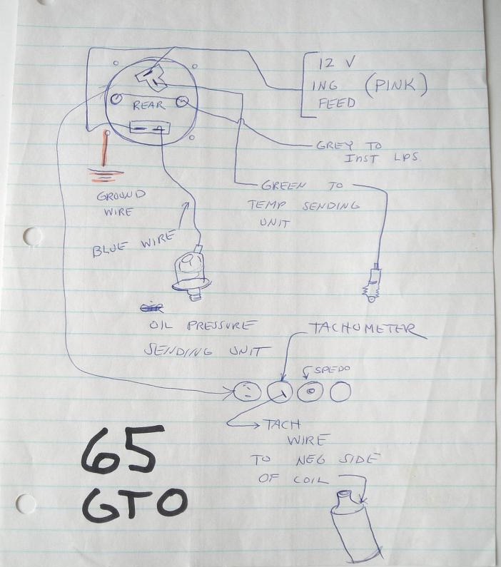

65 GTO dash wiring
3 Attachment(s)
Here is a drawing I made years ago, it could be of some help.
The adapter harness is a actually a copy of a 1965 Lemans-GTO part only. They do sell it new and I guess they say it can work for other years.
For true rally gauges in a GTO for years: 1966 and 1967 (GTO) the entire dash harness including the fuse block was unique to either with or w/o gauges.

Thank you - I was trying not to tear out the old harness and fuse panel, the adapter harness seems like a fairly easy workaround.
When the car gets back, and I have the cluster in front of me, then I think answer should be pretty clear.
Peter Serio 04-22-2026 02:33 PM
That adapter will work on a 66 or a 67 GTO as long as your present non-gauge wiring & fuse block are both in good condition.
