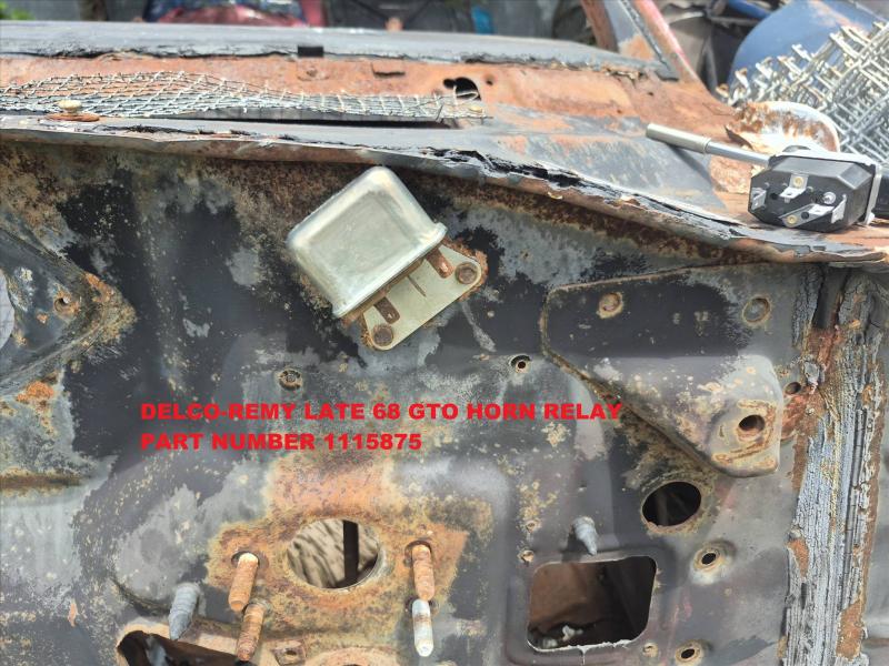

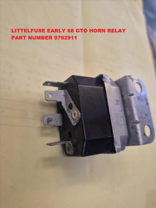

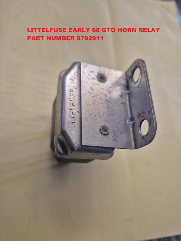

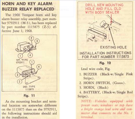

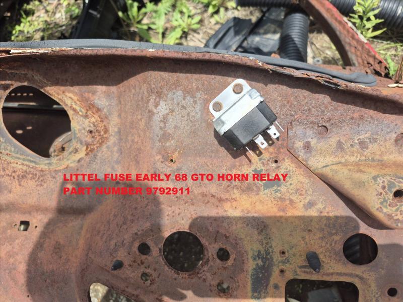

This post is both a tech and a wanted post. Early 68 GTO's/LeMans/Tempest used a horn relay made by LITTELFUSE, P/N 9792911. Around mid-Feb of 68 the assembly lines had switched over to the Delco-Remy horn relay P/N 1115875. The early 68 LITTELFUSE relay was only used on Pontiac A-bodies, and not on any other GM products to the best of my knowledge. A Pontiac Service Bulletin says that the old style relays were phased out from the parts books by June 1, 1968 and that the Delco-Remy style should be used to replace the LITTELFUSE type. So if you have ever wondered why your Delco-Remy horn relay does not match up to the holes drilled on the firewall, this is why.
I am looking to see if anyone has any early style LITTELFUSE type horn relays that they would like to sell in any condition?
Yes, I also know that LITTELFUSE made the A/C high-speed blower relay, which is NOT what I am looking for.

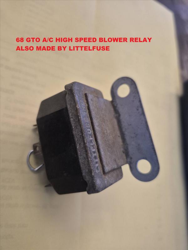

68pongto 06-21-2026 06:27 PM
This is a 68 A/C relay also made by LITTELFUSE, this is NOT the one I am looking for.

I have a 68 GTO born 11/67 with the Little Fuse type horn/buzzer relay.
The people that I bought the car from replaced it with the Delco style.
I found the Little Fuse type on ebay, and I couldn't get the buzzer to work.
You should be able to fine some thing on ebay, just Google the word.
