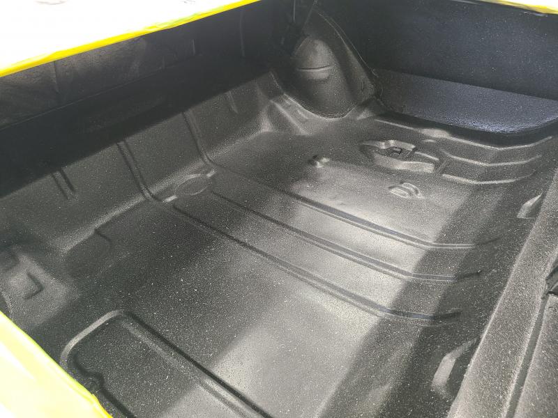

Does anyone have a first hand recommendation for a black/aqua spatter paint that is like the original??? Something close to my pic would be great.
I'd prefer to stay away from rattle cans if possible.

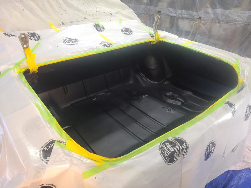

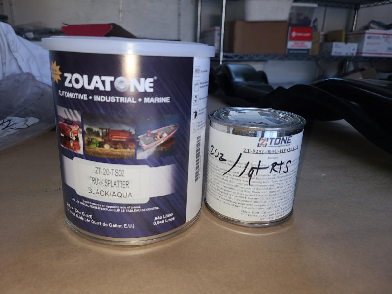

Finished 65 trunk (5 days ago) with Z-tone. Did base coat with black flattened epoxy primer. Sprayed zoletone spatter paint (this one from parts place) with 2.2 size tip. Would have used larger if I had available. Combined with z tone quick step catalyst at 16:1 (used 2oz for 1 qt RTS) Pleased with results and durability...so far. Scrubbed with wet cloth: no color transfer. With lacquer thinner: very small transfer of black (could have been from primer?) Z-tone and quick step catalyst from TCP...will use on next one. Attachment 673212
