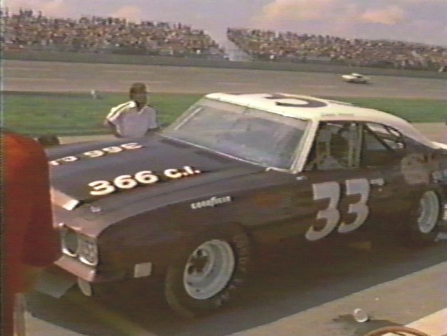

Old 11-24-2010, 07:23 PM
Brian Baker's Avatar
Join Date: Feb 2000
Location: Glen Burnie, MD USA
Posts: 17,184
If there is any wind tunnel info. available for Chevelles around that year, you'd have some numbers, then where to find such info...???
I doubt you'd find any numbers for a Pontiac "A" body, I doubt anyone raced one in NASCAR back then.
Just a thought...
Plenty of A-bodies in NASCAR in the early 70's. Remember David Pearson's?
