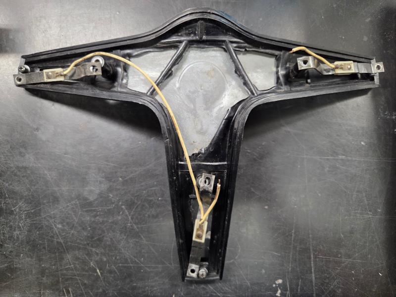

I've had this wheel since the 90's and was cleaning it up and getting it ready to install this winter until I noticed that I'm missing some obvious pieces....
Could someone please post a pic of what I'll be needing so that I can at least sound like I know what I'm talking about when I post in the wanted section?
I do have the plastic buttons. Just not sure how the two wires connect and then complete the circuit to the steering column.

The two wires that are cut extend to a small round connector that connects (with under a 1/4 turn) to the horn contact that protrudes through the upper locking plate & dust cover.
The original steering wheel cover wiring harness should have been left alone to dangle or carefully removed by the brass connector at each horn button.
The small harness should the same for '69 through late 70's Pontiac deluxe steering wheels, looks like you may need 3 correct Phillips screws as well for the buttons.

Thanks, that kinda what I was thinking I was missing too but now I'm sure. So what would I have to ask for so I can go looking, Steering Wheel Horn Pad Wiring Harness???
Yes I'll also be needing the three philips head screws that attach the pad to the wheel.
