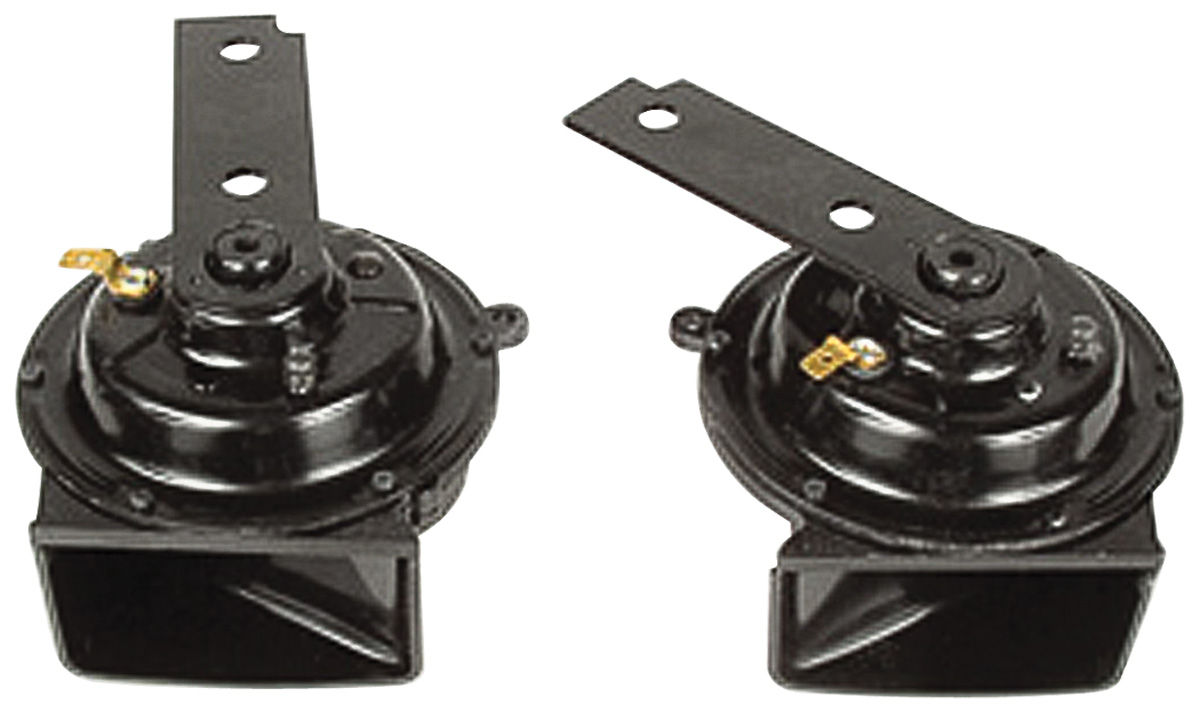

here's a horn restoration shop.
Too much gloss?
http://www.carhornrestoration.com/proc6a.jpg
I am trying to use either different paint, or sheen, or both on all the parts that are black & are bolted together so it doesn't look like everything was painted at one time. more like the way they came from GM. many paints, many suppliers. But if I change I want to error towards the correct sheen.
If I go by the "restoration" bibles. Everything is either zero gloss or 60%.

So what do you guys think on gloss level? Semi gloss, or something closer to semi flat?
Here are a couple of contrasting picts from google by searching delco horn images:

To me, the first pic looks right. The other pics seem way too glossy.

No doubt the last ones in the last photo were spray bombed with high gloss. they don't look good at all.
I am probably going to start another thread on some gloss level questions I have, but do you know if the headlight brackets & mechanisms are the same gloss level at the core support? I took the headlight assemblies apart today & media blasted all the parts. Looked like they were pretty glossy, 60% for sure in area that were protected. Looks like all the parts where dunked in paint rather than sprayed. Every bracket had a heavy run off of paint that was a little harder to remove with the glass beads. headlight buckets look galvanized.
I think I will paint the horns a little more to the satin side.
