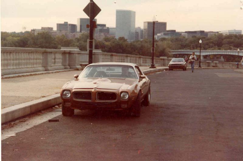

Here's a pic of once I had got it going, one coat of crappy paint, and some mechanical work done, and how I drove it back & forth to training in TN. This was after training, was stationed in Oceana, VA, and had brought shipmates back with me and we did some DC sight seeing and bar hopping. This was along the river by the national mall, with the 14th street bridge in the background. (I changed the hood to a flat hood, and the body shop without my permission molded a hood 'bubble' on it)

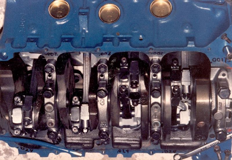

Once that 9" went in, I was on like my 8th 400 (late 80s/early 90s), and decided to do a 455. An aircraft mech buddy of mine said he would build one for me and ended up doing a solid roller, 70 4 bolt block, SD 421 rods, and he ported a set of '70 64 heads. He also port matched a Offy 2x4 intake, and built a pair of AFBs for it.

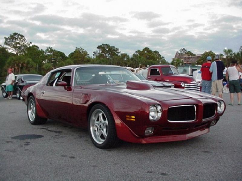

Here's a few shots of this version...
