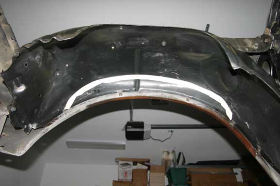

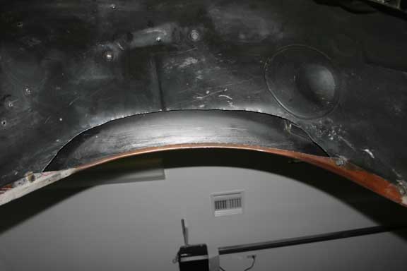

I started work on my front fenders in line with the Herb Adams catalog (from the 80s). I actually cut the inner fender, but didn't take a picture yet. I had to cut almost 3 1/2 inches to get close to the top of the radius. I will post more pics as I make progress.

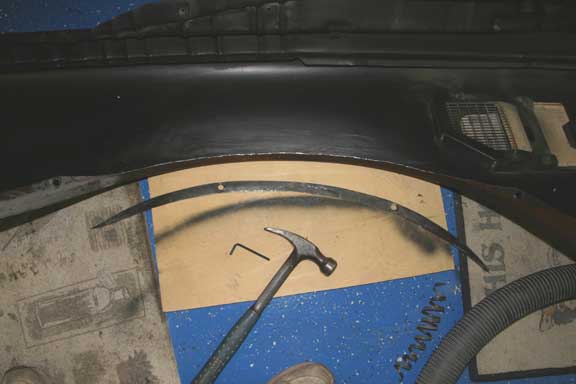

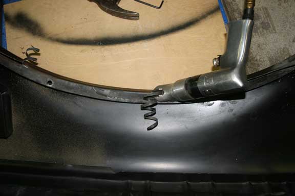

When I set the fender down and started beating the crap out - sorry - gently manipulating the sheet metal, I realized that I would not be able to roll the lip right up without trimming it first. So I had to cut the strip with the bolt holes off.

Trev do you think there's anyway around cutting so much out of the inner fender well? Why did you have to cut the outer fender?

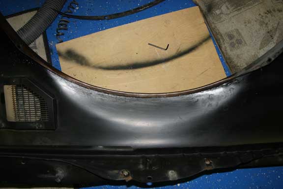

Once the secondary lip is cut away, the primary lip rolls back nicely with the special fender manipulation tool (medium sized hammer).

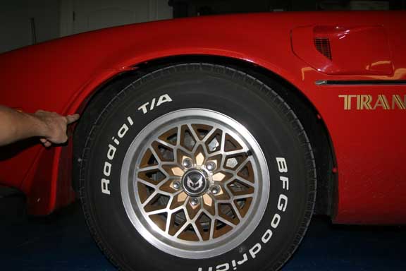

I removed metal so as to only eliminate a maximum of 2 bolts. The front bolt is hidden behind the spat. My finger in this photo shows where that bolt is on my other car. I think I will have to modify the spat for proper clearance. My 78 is too low. I have all kinds of rubbing issues on full lock. Especially when reversing out of my driveway.

Here you can see the lip rolled in nicely. I left about 1/4' gap. ie. I did not roll it in tight so that it touched the outer fender. I can fill in behind the roll with silicon or mastic to protect from corosion. It will have a more solid look too, as it leaves a bigger radius. I did the same thing to the rear fenders. No cutting required there though.

Gordy, If you do not cut that much off of the inner fender well, then you leave the sharp metal edge pointing down, and risk cutting the tire tread on full bounce. I decided to cut the secondary lip off of the outer fender because to beat it out of the way would probably have distorted the outer fender shape. By cutting away the excess, the primary fender lip folded in easily. If you are going to run a narrower tire, then you could get away with it, but the 255/60x15"s on my 78 are already too wide.
