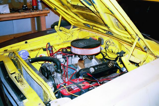

And a picture of the not so pretty engine.

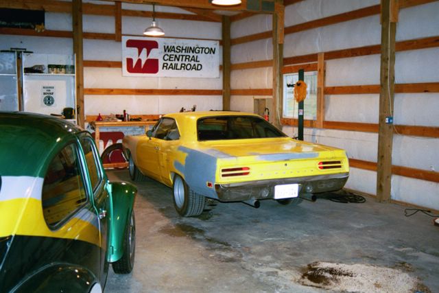

Yes, and here is one that gets 15mpg with a 4-speed, 3.80 gears, and 414rwhp. It's not a Poncho but it's an example. It isn't pretty but it works.
