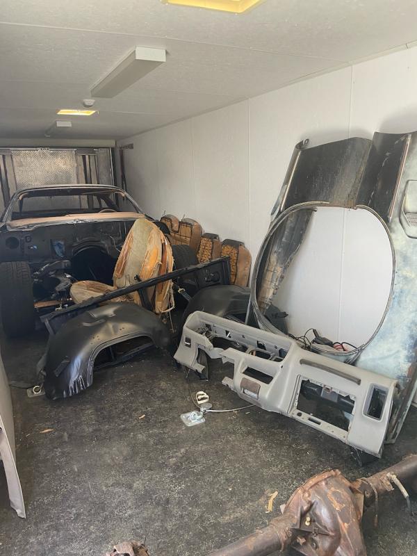

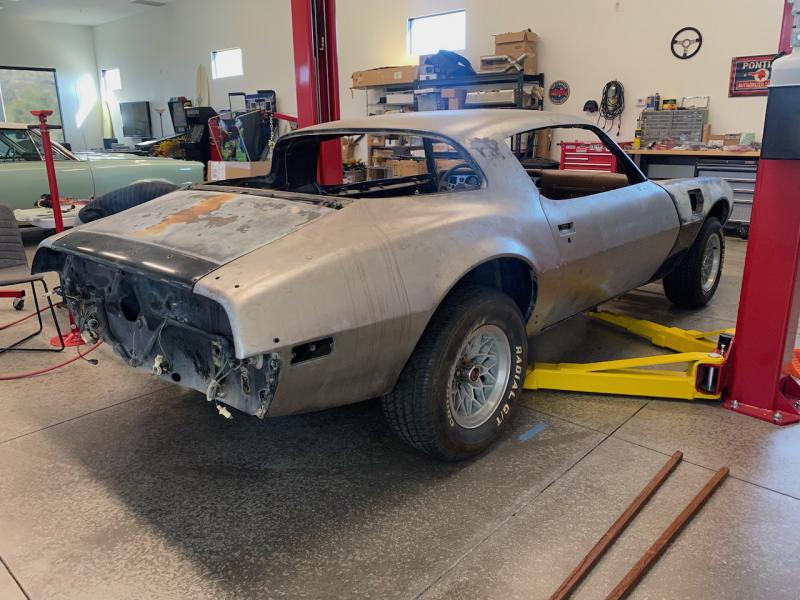

About two years ago, we picked up a 79 Trans Am to work on with my son who was 17 at the time. A previous owner started a restoration, but it stalled, and a friend bought it. It sat in his trailer for a couple years until I mentioned to him that we were looking for a project. Here it is in his trailer.
It's a true Y84 car sans the original 403 and automatic transmission. It's completely rust free and no sign of any collision damage, so nice starting point. It's also a non t-top car, which my son prefers because he plans to do autocross and other track activities with it. Our original plan was to restore it on a budget with updated engine, driveline, suspension, brakes, etc. We're mostly holding to the plan, except for the budget part.
It will take a few posts to catch up to where we are on the project now. Here's the car, and everything that came with it, at home in our shop.

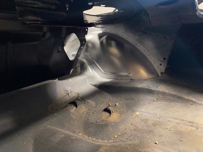

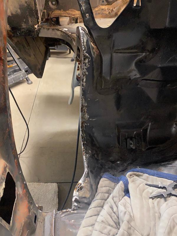

My son's first project on the car involved welding up the holes where the body side moldings were attached.
His first major project involved installing the mini-tubs (so he can run 335 30 18s). It probably took him 30 or so hours.

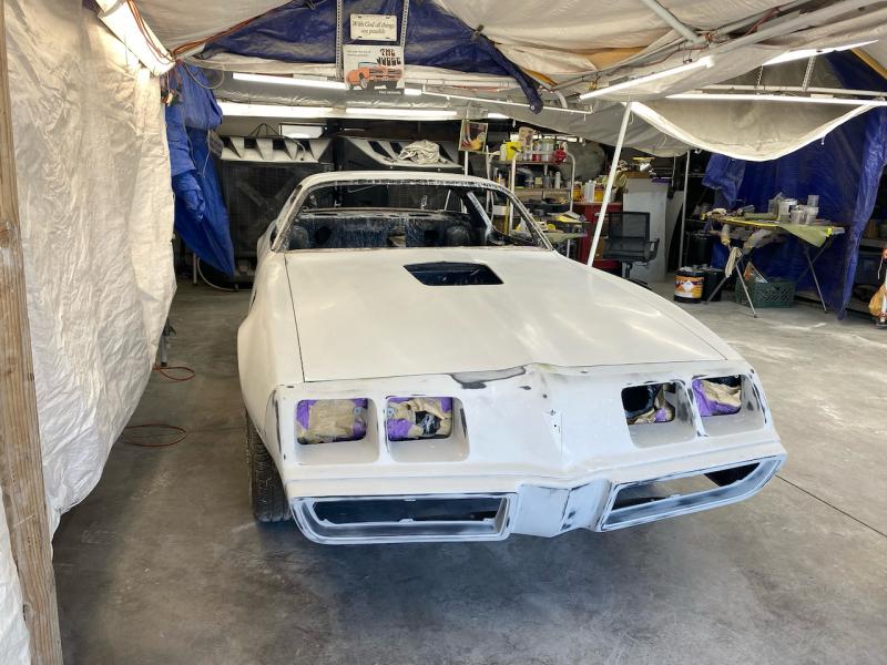

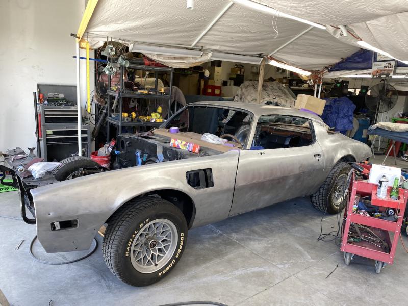

After the mini tubs were installed, we hauled the car to a friend's place. He volunteered to help us prep and paint it. The original plan was to get it done quickly (in a couple weekends), but he convinced us that given how nice the body is, it would be worth taking our time and doing it right. It ended up taking 9 full months. Lots of weekends spent sanding, but it was a great experience for us...my son now knows what it takes to do this type of work. It did turn out really nice. We used single stage so the black is really deep.

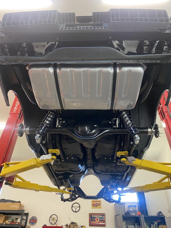

We had the subframe powder coated. When it came back we installed solid full height subframe bushings from Speedtech, and Ridetech's full coilover front suspension.
We started to install the Ridetech 4-link coilover suspension. But after seeing what this involved, we decided to run the fuel and brake lines first. We had custom sized hard lines made which we flared and installed tube nuts (3/8 fuel, 3/8 return, 3/16 brake).
Went with a 9", Richmond 3rd member, 3.25 gears, Powertrax Grip Pro differential. Had the differential housing made with Torino ends, and factory width so that we could run rear wheels without a deep dish.

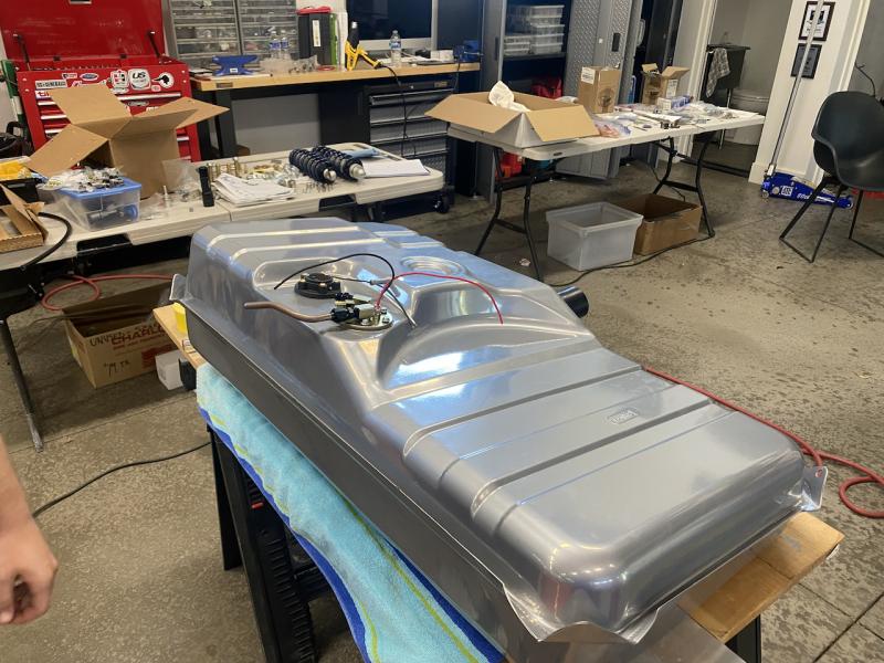

The tank is from Tanks Inc. We went with a Walbro 340lph turbine style pump, which is compatible with the PWM fuel controller which we plan to use.
We went with 14" Wildwood AERO6 front brakes. Can also see the Ridetech TruTurn and Borgeson 12.7:1 steering box installed. We're going with custom front sway bar to accommodate 295 front tires.
In the rear, 13" Superlite with electronic parking brake.
Test fitted the 408. Used Holley engine swap mounts.
