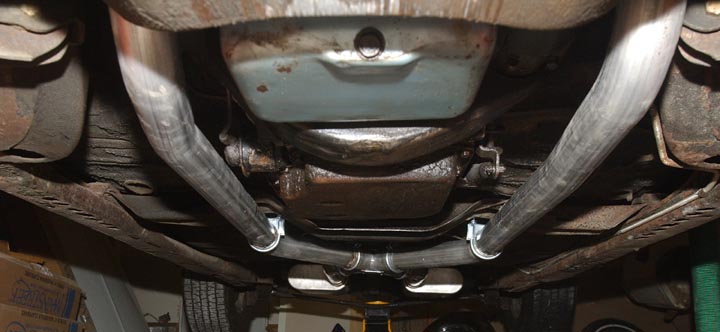

Here's a pic. It's hard to get a good shot on ramps and jack stands!

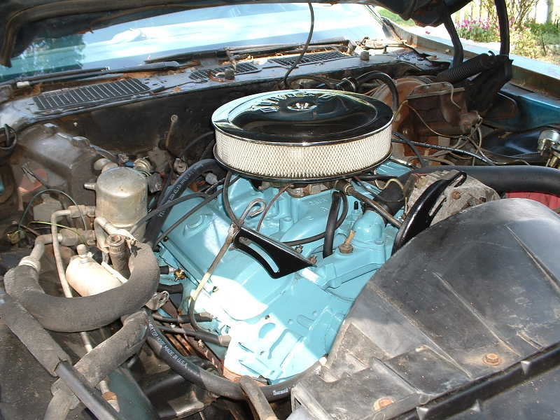

Here is a Pix of the Firebird's engine.

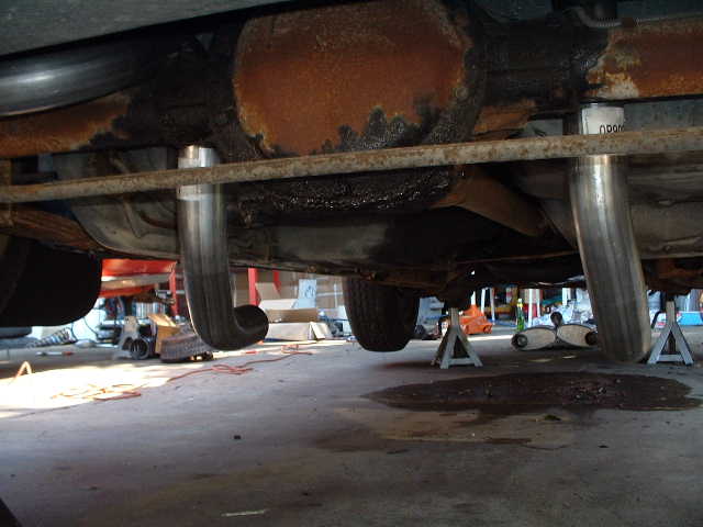

Having the car off the ground is a wise idea!
I seem to have an abundence of Jack stands!
Here is the ends I put in place. they slid together and I then Hung them from the stock origional hangers that were in good shape! The kit comes with New hangers to replace them if needed.
