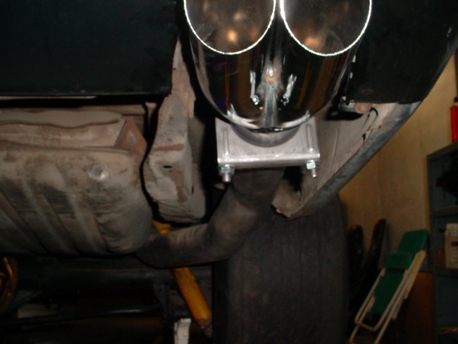

I had the same tailpipe angle on my '69 where it would bump the shock perch or the frame rail just before the tips and they were pointing a little down compared to the fender line. I marked mine in position so the exact top and bottom, as test fitted, was easy to see and took them by a local shop. They put about a 3-4% tweak upward in the last bend to the tails and it fixed it all for me, but be aware that once you bend them you can't exchange them. With your '70, the smaller margin for error that you have to hit the cutouts, I'd say take them to the muffler shop and have them do it with the car there. Good luck on it, mine came out great after I figured out that one problem, Rick

Hey Matrix, that is my car on the Pypes site. I cut mine to size and installed it with the head pipe flanges and rear muffler clamps in place to hold the system together. I found a good custom muffler shop in my area and they welded all the connections plus made another tweak to the tailpipe extentions to make them match each other. They charged me $140 to do it which was only a little more than I had been quoted for just the welds alone. With the x-pipe, they ended up having to do 10 welds including the extensions, plus I had them weld the tang of the rear frame hanger to the pipes as well so the tails would stay in line with the frame rails. Trying to make yours all line up and come out those cutouts is something that would be tough to do without some way to bend the pipes, so I think you'll be glad if you let the shop do the final tweaks/welds. Good luck on it, Rick

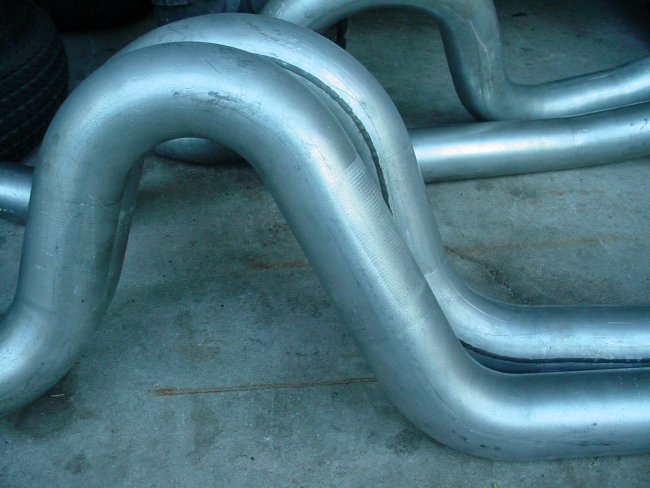

The problem I had with my PYPES is the over-the-axle was a U-bend and hit everything. Torque Tech pipes differed.

I sure from what your saying that the torque tech pipes are a good fit too. My only problem with the Pypes system was the rear tailpipe system, which was easily tweaked and I think after some feed back, Chris has corrected any problems in the tails. Most of the cost of the extra $140 that I spent for mine was because I wanted welds everywhere for a clean look and no chance of leaks. The bends with labor time might have been $40-$50 of that cost at most. I cut and installed the whole system with the X-pipe front to back, drove it to the shop and had the welds and tweaks done in a couple of hours. I just didn't want to use the clamps for looks so most of that cost was my choice. Here's a pic of the system after I installed but before the welds. Very good quality system from Pypes and it sounds great. Rick
