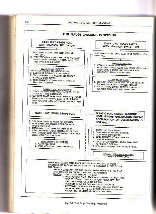

Here is some info that may help.
Patrick

Thanks for posting that image from the service manual lethal-428-lemans. My gas gauge never goes past 1/4 full (but it will go down normally from there). Now I have a clue how to check the problem.
