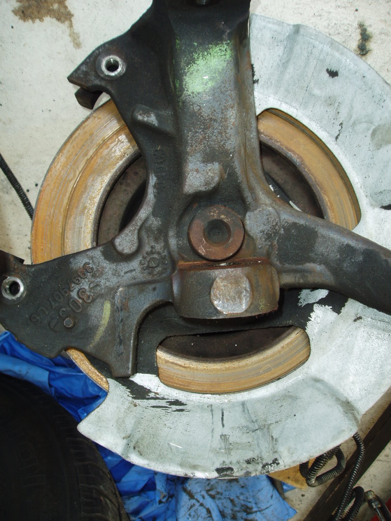

Here is the driver's side front spindle. There is green paint near the upper ball joint area and a yellow paint line by the spot where the lower control arm metal stop hits the spindle.

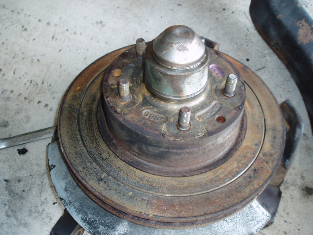

Here is the driver's side front rotor. It has a white or light blue paint daub on the outer cone area where the wheel bearing cap attaches and orange paint in the area where the minimum thickness number is cast in.

Here is the passenger side rotor. It has a white paint daub plus a green one next to it. The inset portion of the rotor that has the minimum thickness number cast in it, is painted pink.

Here is the pass side spindle. It appears to have a light blue paint mark in the same area as the green one on the driver's side spindle.

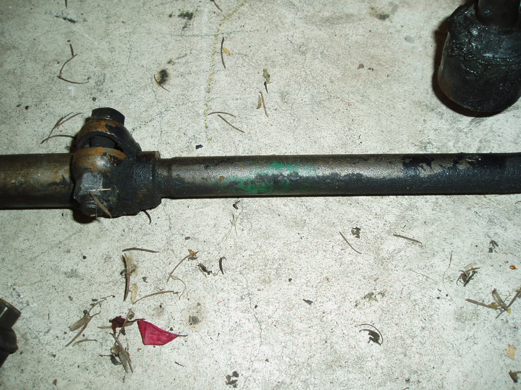

Here is the drivers side inner tie rod with a dark geen paint mark on the tube.

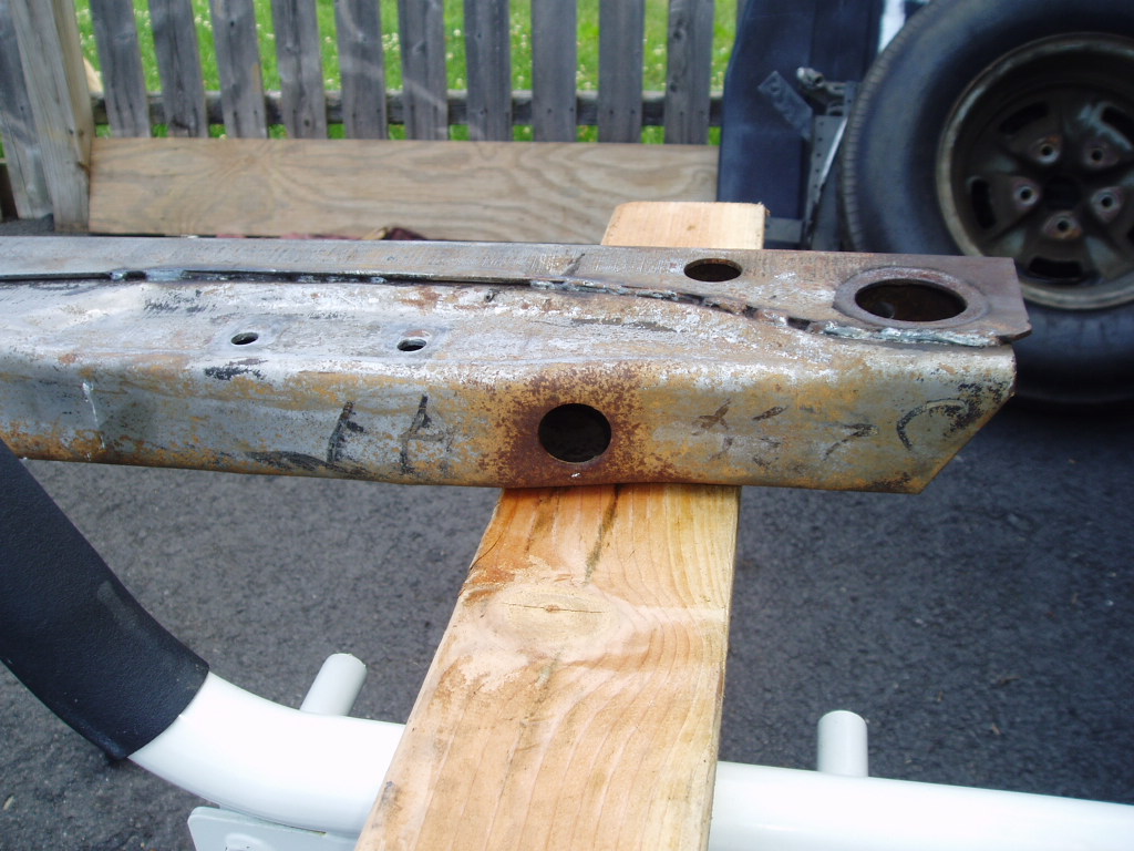

While pressure washing the frame I found something interesting. The paint came off rather easilt and on the passenger side inner frame rail at the rear, was a part number hand printed with a magic marker.

Here is the number right side up.

Here it is upside down. Any body out there know what this number is? Looks like a 5236 44. Does this correspond to anything?
