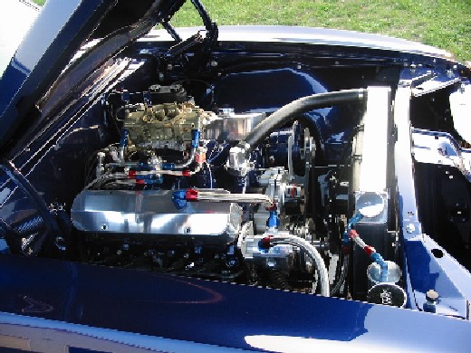

couldnt figure out how to show 2 pics in one post, so heres another picture.

hey badbird...noticed the water neck housing is adapted to the crossover a little differently.
care to let me know what you did? i need to do something similar to mine to give the upper hose more clearance around the valve cover.

Thanx for the compliments. Sorry the pic isnt that clear.
Larry, a friend of mine made the adapter. It bolts on the the intake like a regular pontiac does and the other side is a "CHEVY" bolt pattern waterneck. I bought the CSI swivel waterneck for a chevy and works out excellent. I dont know if he will make another one, but CSI said they were going to make a swivel water neck to fit a stock pontiac bolt pattern. Havent seen one yet. The adapter is a pretty trick piece.

Looks very nice!! In response to the water neck, I would buy one too! It may sound crude, but I have for a number of years used a small chev waterneck and filed the holes a little to make it fit the POntiac. You can't tell afterwards and it has never leaked. [img]/infopop/emoticons/icon_biggrin.gif[/img]

Damn, never thought about doing that. Would have saved a lot of time. Now everyone else knows what to do.

I assume you mean you filed out the bolt holes a little? This sounds like a pretty slick idea. Especially since there are more options available for the SBC than for us Pontacs [img]/infopop/emoticons/icon_frown.gif[/img]
