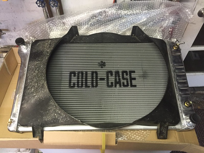

I realize this thread is a few months old, but I just got a Cold Case for my '68. Thought I'd share a few pics since I haven't seen a lot of posts on them.
Haven't fully installed it yet, but I'm not seeing how there could be an issue with the petcock. Fits great in the bottom mounts, the driver's side tank is about 1/2" more narrow than the stock tank, so the mount has some extra space but I don't think it will be a big issue once everything is buckled down. Side note: need to flip my insulators on top, I think I've got them backwards.
It won't be mistaken for a stock radiator, but once painted black it will definitely look at home. All in all looks like a nice piece at a great price. Much closer to stock looking than any of the other options out there.
By the way, I originally ordered the one listed in this thread from Advance Auto. It was not stock looking at all. Aluminum core with plastic tanks. Back to the store it went.

Painted and installed. It blends right in. You can't use the stock overflow hose clip because of the way the tanks are welded to the core. Not a huge deal - I'll have to find another way to clip it.
