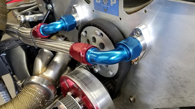

Have you got enough room to "clock" the Chebby _16 adapter 20 degrees and re drill and tap the motor plate to accept the fasteners (assume the mounting hole spacing is different?)

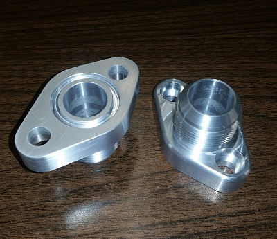

If the front plate was off, that might have worked, I'd need to check though.
Jon Gunter (Bayside Billet in Pasadena MD 410-437-9749), reached out last week to see if he could help and cranked these out for the RAVEN in under a week. Great guys to do business with.

They look great, love it when a plan comes together ��
Those are nice!
May have to contact him for a pair of -12 adapters.

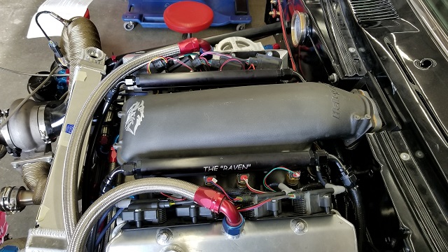

When the Laptop is talking to all the Relays and Sensors means we're almost ready to fire this 2500 horsepower PONTIAC Engine.

Hey Stan,
We're close, had a few leaks to take care of, defective starter, and a timing light that wasn't behaving. Where this is my first time with EFI, there is a bit of a learning curve too. I have to look into a couple of things for the next go. After talking with Jeff Williams on the ride home, it may be something as simple as the throttle blade was closed. I also need to figure out how to look at the cam and crank sync data log. I believe the crank sync is fine as we're seeing RPM while cranking, need to check that we're also getting a cam signal.
Overall a good day though.
Jon Gunter and Luhn Performance came through and delivered on the parts I needed to get even this far today.
