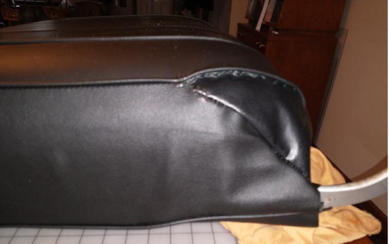

As I said before, I repaired the broken clip at the back of seat--driver's side. I also just added 2 new lengths of listing wire to firm up and help distribute the weight more evenly across the seat. As thick as the new foam is, I don't think new wire will be pronounced in seat feel. Hope not anyway!
The springs are a slightly weaker on driver's side but there is only 1/8" variance from front corner to front corner. Not as bad as I was expecting.
Next, test fit cover and see where to add more vinyl on back corners of the seat. Not sure it will be needed but can trim off whatever is not needed after seat cover is on. Anyway, it will already be there if needed.
