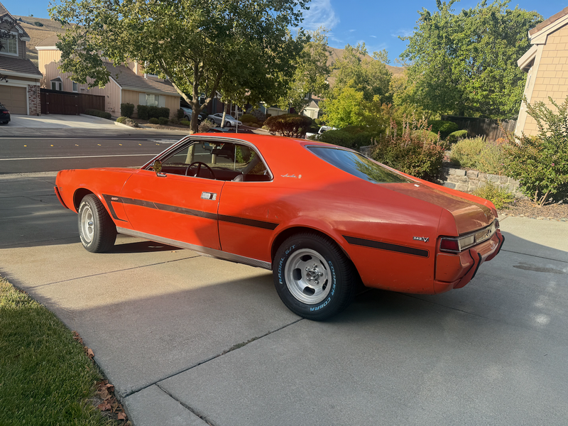

On a whim, I took it out for it's first drive around the neighborhood today. I'm sure it's the first time it's been mobile since the 90's.
I had a little trouble with the shifter and clutch. They may just need some more adjustment, but it's pretty fun to drive! Definitely feels Roadkill-ish right now with 1/2 the interior, the beat exterior and the exhaust dumping in front of the rear axle.
Leaving the driveway: https://youtu.be/u0RaY9xPS28?si=ZgbB0sGV7Y4NUEZr
It's bondoed, weathered multicolor glory: https://youtu.be/kwofgt1XNKY?si=4snjm_AMxtgkzLOc
Here's the good side. If you squint your eyes, it looks pretty cool.

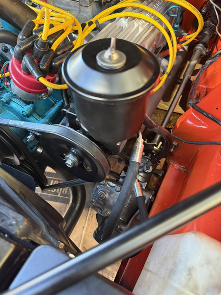

I tried rebuilding the power steering pump twice, but it was stubborn and refused to work so I went for a replacement. At over $200 the Eaton pumps aren't cheap! Went ahead and replaced the leaky steering box with a rebuilt fast ratio while I was at it.

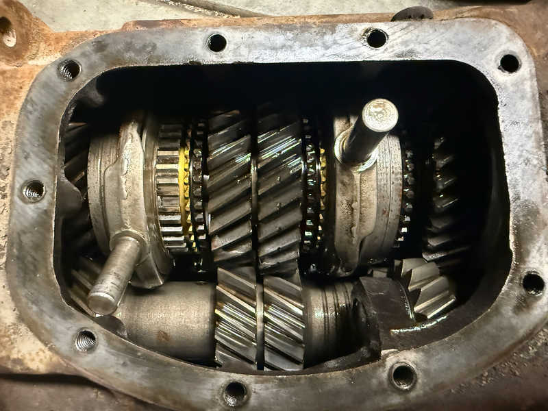

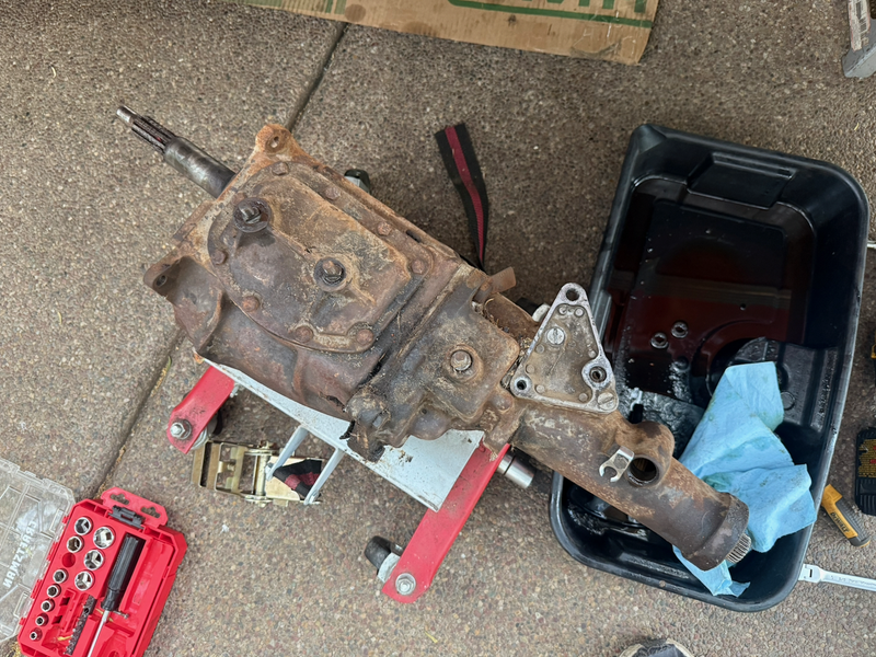

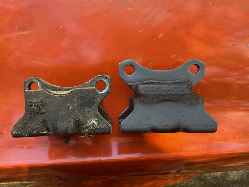

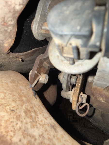

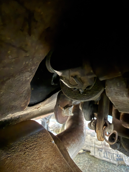

Ironing out the transmission has been a big focus. The trans mount was completely collapsed and the shifter ears were sitting on the cross member. The new mount raised the trans up at least an inch solving the shift issues.

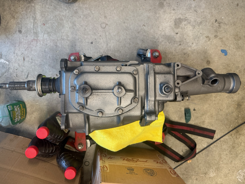

Unfortunately the new mount didn't solve the angry 1st and 2nd gears. It had a horrible grinding and occasionally popped out of gear on deceleration. The internals don't look bad, but the shaft has a lot of play so the bearings must be shot. I considered rebuilding the trans, but lack access to press and figured a shop would be at least $1k. I put a local feeler out and picked up a rebuilt T10 out of a '70 AMX from a guy who swapped to a TKX. I'm rebuilding the shifter while I'm at it.

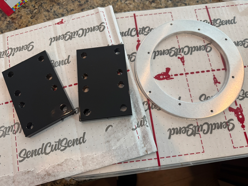

The front wheel bearings are also noisy, so we'll be going through those soon. I had some lowering blocks made via SendCutSend so I can drop the front an inch or so while I'm in there.

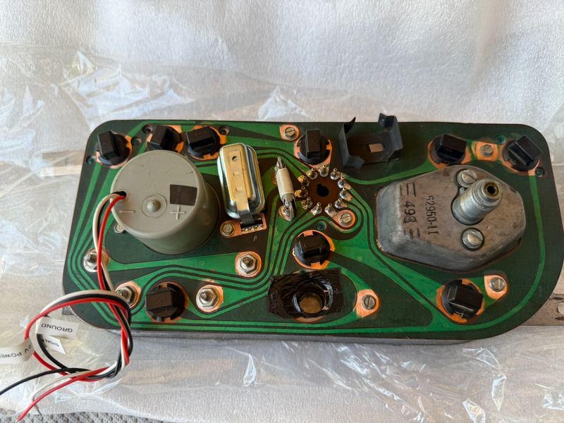

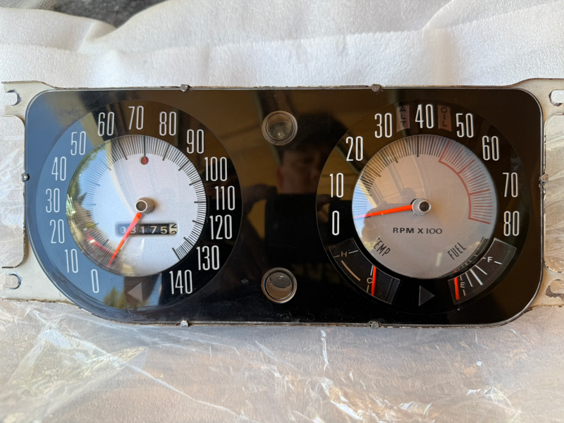

I went round and round trying to get the factory tach to work. I sent it off to a local specialist who determined the Faria movement couldn't be calibrated. He referred me to Redline Gauge Works who converted the tach to Speedhut guts and went through the gauges.

The tach replacement is amazing. Good call! Is the PCBA new? Looks it!
