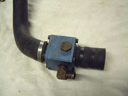

G'day Leigh,
I ran one of John Bennetts systems for years on a WB series 11 Caprice. I ran that car for over 12 years WITHOUT any cooling fan at all. Just electric fans for the A/C. That car NEVER boiled or ran cold. When I decided to let the old girl go (450k on the speedo was too much for a daily driver), I put the car back to stock. Ran like a pig!!
I keep meaning to take a Pontiac Water Pump over to John to get his opinions on it. I'll bet he has a bit to say. That guy has been studying cooling systems for 40 years. Nice old bloke.
Here's picture of the old bypass which I pulled out of my WB.
