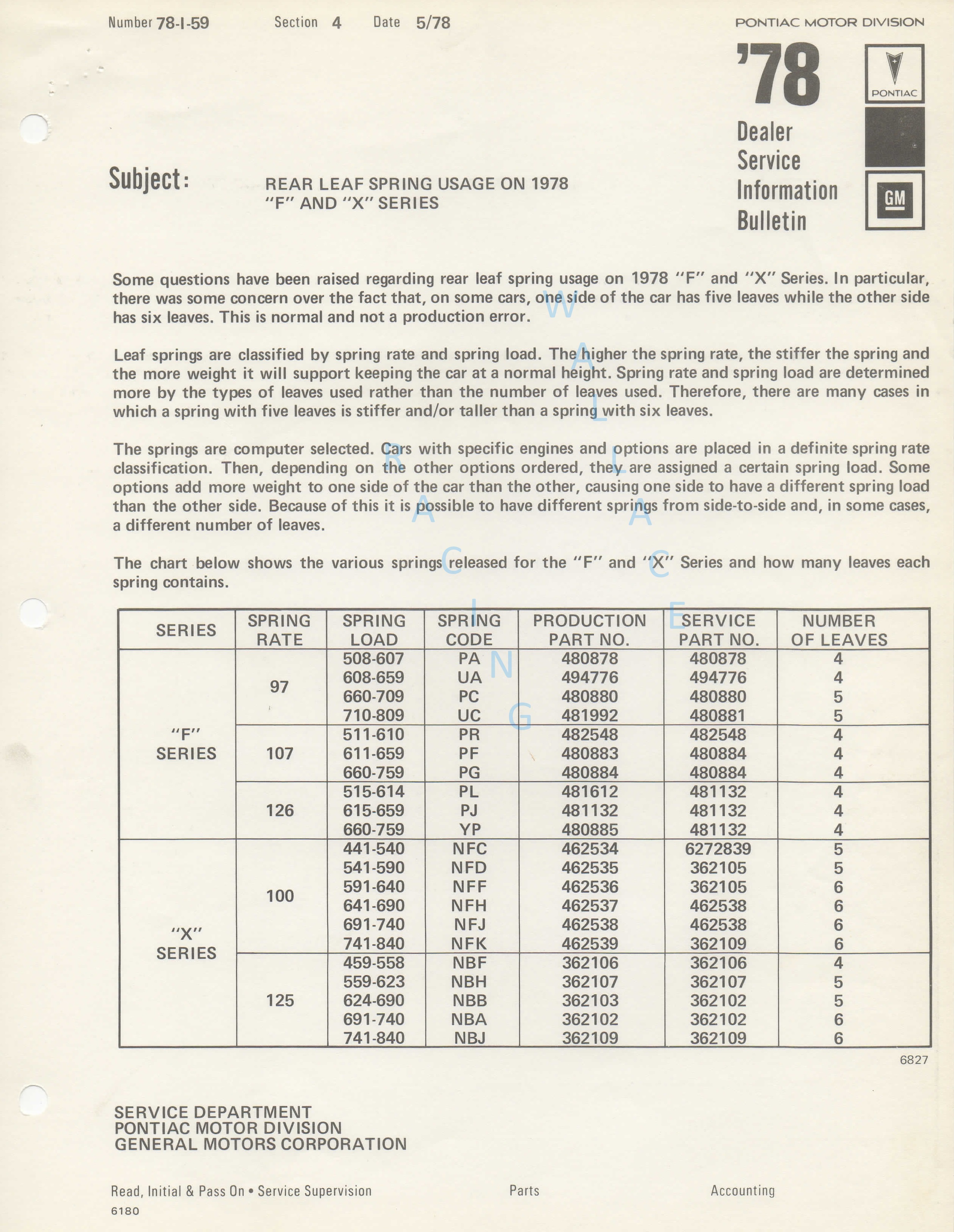

Posts: 22,516
Bulletin on 78 leaf springs, having 5 or 6 leafs
1978 Leaf Springs bulletin

Interesting chart. Gramma's car had "PC" listed on the broadcast for rear springs (right and left). Chart shows that as 5 leaf, 97 lb rate, part number 480880.
