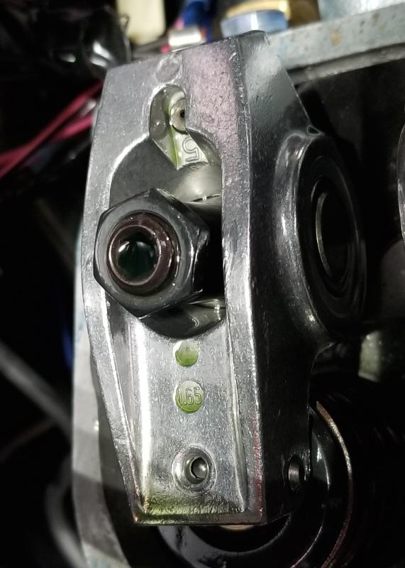

[QUOTE=HWYSTR455;6368491]
Originally Posted by Va68goat View Post
Go back and look at the pics, the hex on the polys were contacting the rockers, I remember moving them around and watched them contact, think it might even be on your thread. Understand it wasn't the core issue, but it was happening.
I went back and found the pictures. The guys that saw this in person and in photos thought this was a wrench mark of some sort and not a clearance issue. I doubt Paul would have missed this during assembly.

[QUOTE=Va68goat;6368629]
I don't disagree that the damage could be a wrench kiss. But the setscrew sticking out of the rocker arm nut looks like short pushrods to me. Or the trunnion was upside down. Either way, something was not right there.
If those are die cast Crane roller rockers I would not use them on a engine I cared about.

Old 08-30-2022, 06:53 AM
HWYSTR455's Avatar
Location: Winchester, VA
Posts: 16,210
Originally Posted by 64speed View Post
Valve tip and intact rocker
HOLY CRAP! Half the tip of the valve is worn away, and the retainer has all kinds of witness marks! I bet the tip of the roller fell off the edge of the valve tip and hung up.
Pull a rocker that didn't let go and take the same pics, as well as the underside of the rocker, bet you will see the same thing.
Old 08-30-2022, 11:40 AM
NeighborsComplaint's Avatar
Join Date: Aug 2009
Location: Elgin
Posts: 2,591
That's how I see it too. Seriously side-loaded on contact. Would love to see the roller and underside of the rocker as I suspect the end of the trunnion slot is going to mangled from overtravel binding due to the geometry issue. Also, marks on the pushrods below the normal guide plate scuffing would indicate pushrods contacting the slots cast in the heads. This all could have started the ball rolling with the lifter getting displaced. The fact that both lifter bores broke says the OP "won the lifter lottery" and had both lifter wheels fail simultaneously, wedging both lifter into the cam.
