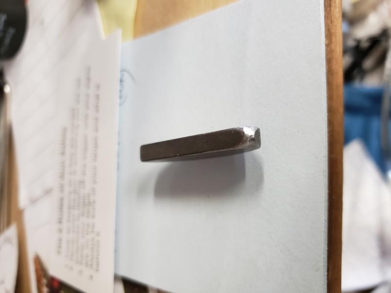

I also doctor the keys, so the one end is a little pointed and narrowed, to allow for slight variations of alignment.
