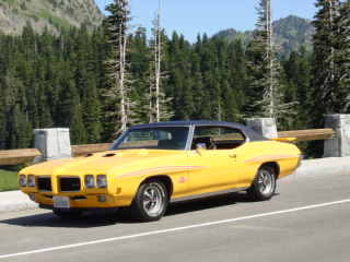

I own a 1970 Judge, built April 8 1970, Oshawa, On. I have all of the paper work from General Motors of Canada Limited. Some of the options that you are talking about are B93 Door Edge Guards, D80 Auxiliary panel & Valance (Spoiler), Y 86 Decor Group, and WT1 Judge Option. I added the chrome trim on the valance of mine, and the chin spoiler. But I have to say that the holes where there for them. Have many more option codes on my car if wanted.

Nice cars but they shouldn't have chrome trim on the front valance.

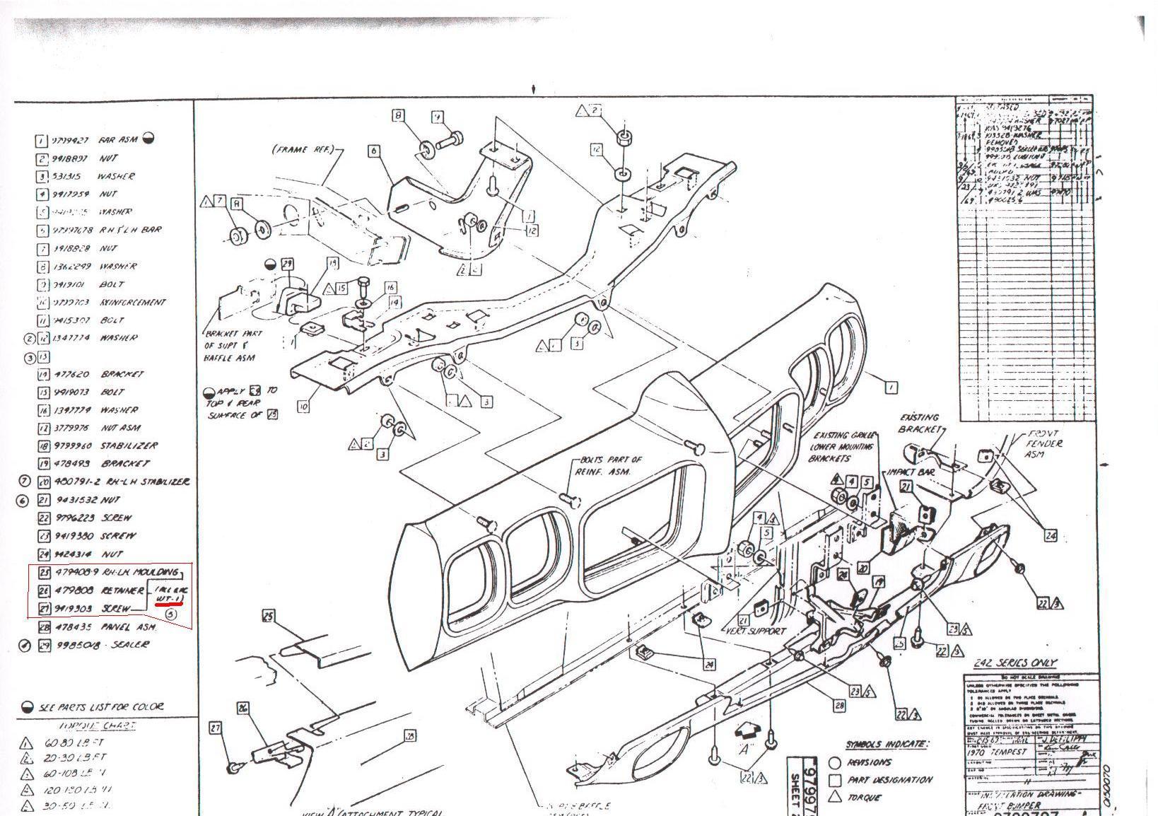

<BLOCKQUOTE class="ip-ubbcode-quote"><div class="ip-ubbcode-quote-title">quote:</div><div class="ip-ubbcode-quote-content">Originally posted by Gordon Church:
If you look in the 70 GM assembly manual it's clearly indicated mouldings,retainers and screws "all except wt1" the drawing # is 9799797. Other proof is my Judge that left the Oshawa factory with wheel opening mouldings and no valance chrome this car is untouched low mileage original. Maybe cars with chrome are assembly line mistakes? </div></BLOCKQUOTE>

Here's a scan of the GM drawing

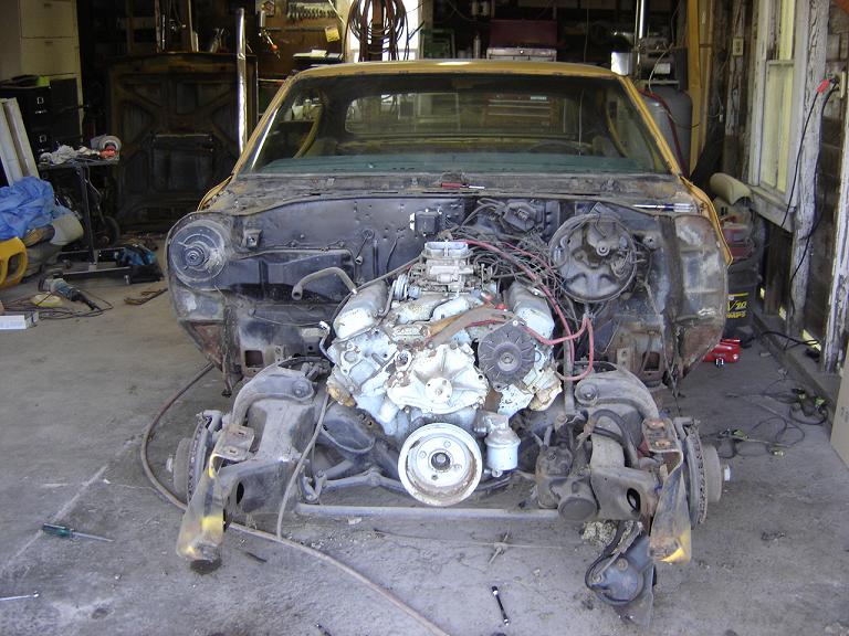

Heres mine now!! Disassembling for body off restore.

I just went out and looked, and mine has the chrome. I spent part of the day yesterday, tearing the Judge apart, looks like the floor and trunk are very solid. Next I am pulling the dash to send to Just dashes. May send them my headrests too.
