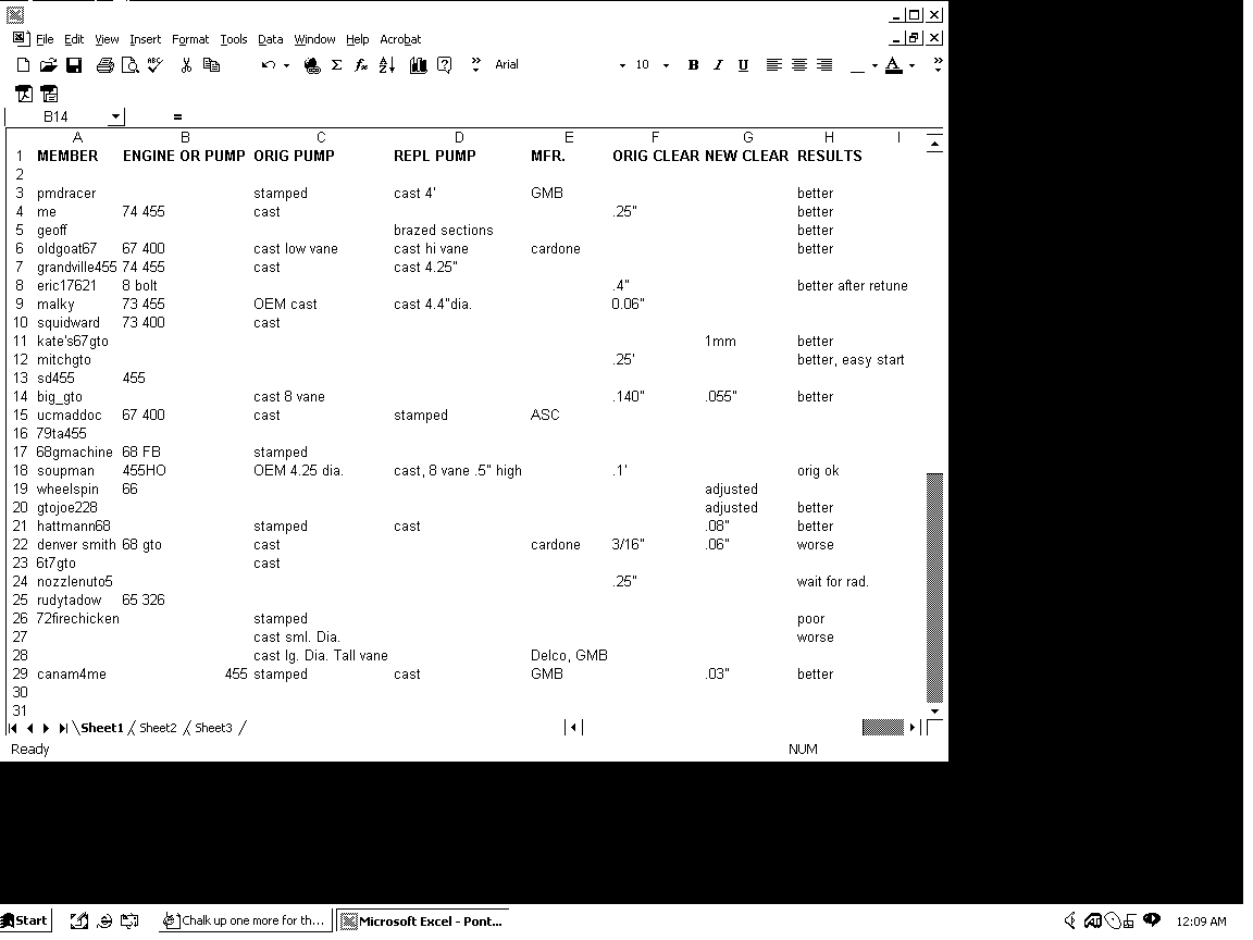

Here is what I have compiled so far:

From what I see here, some items stand out:
On a 8 bolt pump, two cast vane heights exist, with the higher vane being the OEM design, as found out by OLDGOAT67. The smaller vanes leave way too much clearance to be effective.
On a 11 bolt pump, the one to get is the larger diameter impeller as specified by MALKY, who has a known OEM style pump. Soupman also has what appears to be the same OEM pump. 72Firechicken has both flavors of cast impeller on a 11 bolt, with the stamped impeller actually being BETTER than a smaller diameter cast.
Cardone seems to be a good supplier of rebuilt units and Delco and GMB have pumps similar to the OEM dimensions.
Stamped impellers are generally inferior.
I have no idea where the other variations of cast impellers come from or what they were used on.
I'll update the list as more results come in.
Anyone have other opinions or something I missed?
George

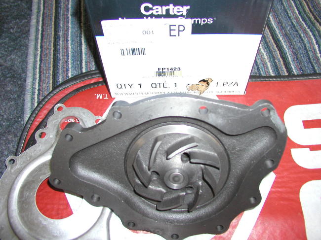

Just got my Carter Pump heres the pics.
New spacer plate too, it has .060-.080 clearance as is, is that close enough?
Steve

Wow! That looks really nice! Looks like good vane size also. From members' reports, .060 should work well. Can you take some measurements of vane size, length, etc? How much for that pump, KS?
George
