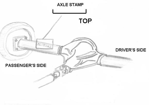

This might help. I think it's a 8.2 rear.That's what is in my 69 GP/428 3.23 rear. The 8.5 are Corporate rears that started in 71. not sure though. Please help this guy & myself. I could sure use this info also.

If it's the original, it's an 8.2. Here's a pic that shows what a 8.5 loks like. it will have squared off bottoms.

Stock '67-69 8.2 Bird rears have bolt in axles with one access hole in the axle flange. Will have to remove rear tire & one brake drum to see this hole.
Not all 8.5's have the squared off "bottom", but an 8.5 Nova rear will, if stock, & bolted in a '67-69 Bird.
