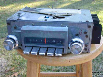

You can keep an eye on eBay, that's how I got my 69 FB AM radio. Just make sure you have good pics of a 69 - just in case the seller isn't sure. Got mine for $50. The AM-FM are $500+ (picture from eBay) / the AM-FM stereo go for $1,000+
Wally
