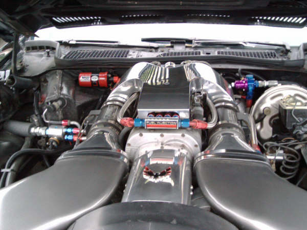

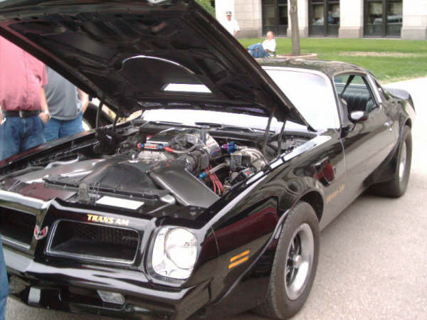

Sweet daughter!! I would talk with Larry Navaro or Steve Combs both have nice looking and preforming firebirds....they both have been there done that with the firebird. When I had my 76 455, 4spd TA I went with Herb Adams parts and the t10 tranny mild build...it was a great car! Here is a bueaty...

the car.....

B&M supercharger, NOS, FI...all hand made...
