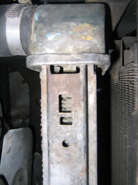

Another question i have is: How can i tell wether the radiator i have now is a 3 or 4 row????

If you look at the radiator, a 3 row will have about a 1/2" edge from the rows to the edge of the tanks, a 4 row will pretty much go all the way out to the tanks.

Cool, thanks Joe!!! I guess that will make mine a three core.
Thanks for the info.

<BLOCKQUOTE class="ip-ubbcode-quote"><div class="ip-ubbcode-quote-title">quote:</div><div class="ip-ubbcode-quote-content">Originally posted by Lobito's65Cat:
Thanks for the info. </div></BLOCKQUOTE>
Yup, thats a 3 row for sure.
