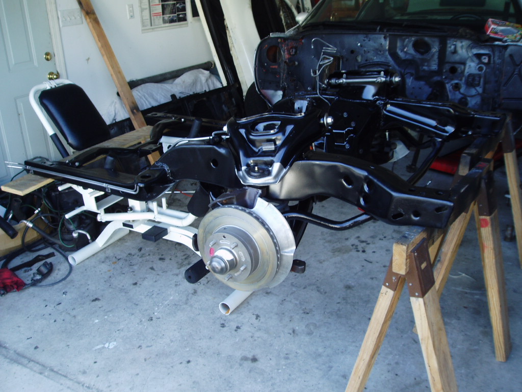

Got the frame painted and partially assembled. I had the wife help me gently lower (read that as drop) it off of the saw horses and onto the ground after taking the photos. It was getting a bit too heavy up on the stands. Now at least all the hard work is done and the rest of the steering and other stuff can go on. It's also much more handy to be able to roll it around the garage on a set of tires.
And yes, I am still using that "Abdominizer 5000" as a partial frame stand. It will be available for rental once I'm done with this project.

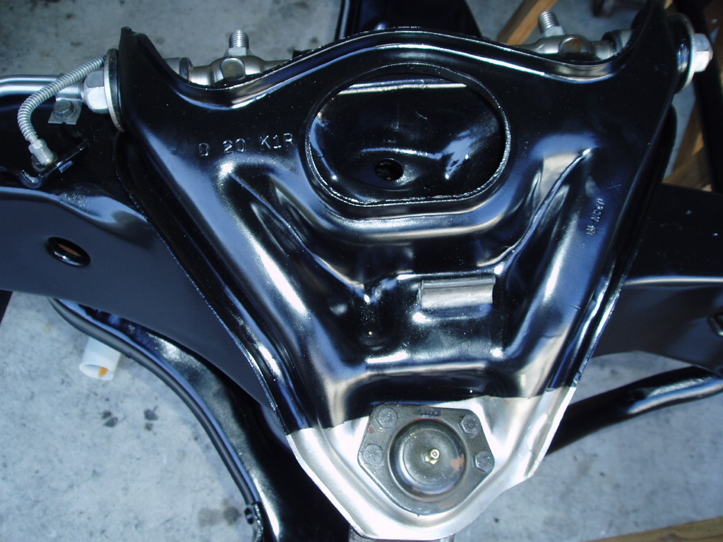

I repainted the control arms exactly as they came off, I also touched up the original marks on the rotors. You can see the stamped date codes on the upper control arm.

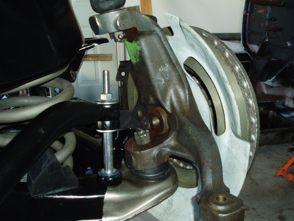

I left the spindles exactly as I found them. I cleaned them and then sprayed a wax preservative on them to delay any rusting. The rotor dust shield were power washed, which returned them nicely to their original galvanized condition.

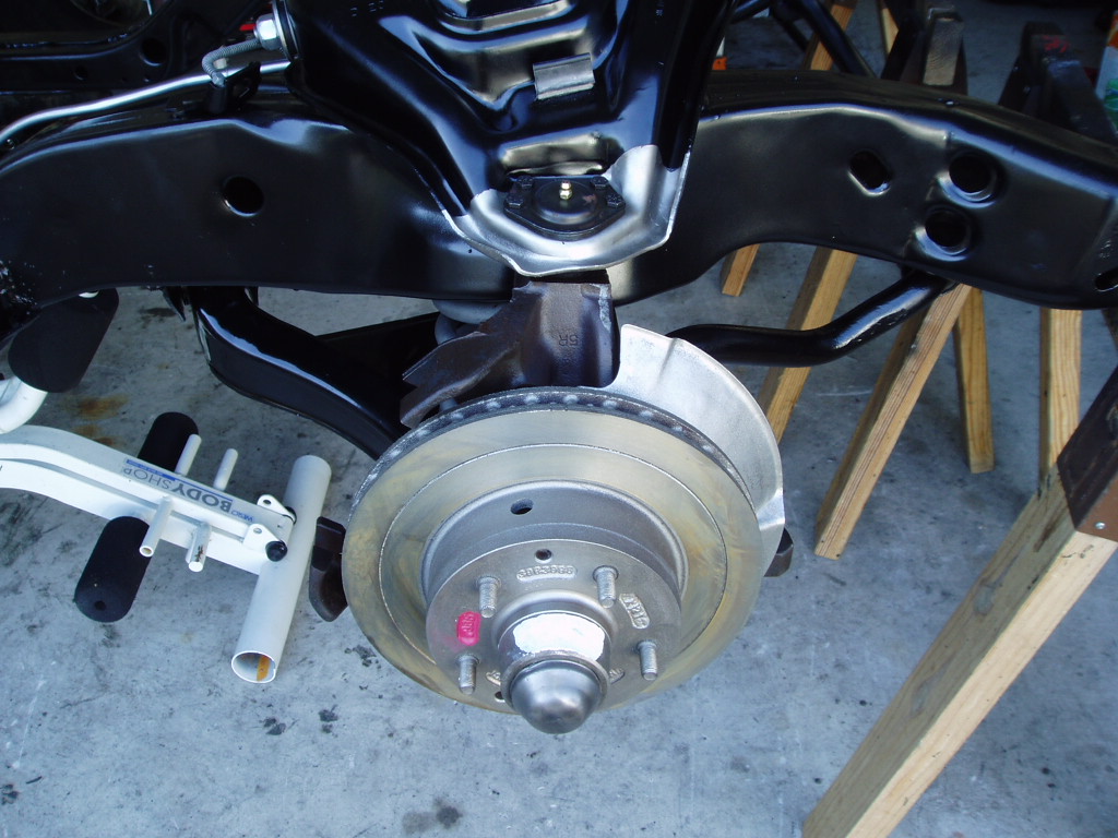

The car still had its original rotors, which were cleaned and resurfaced.

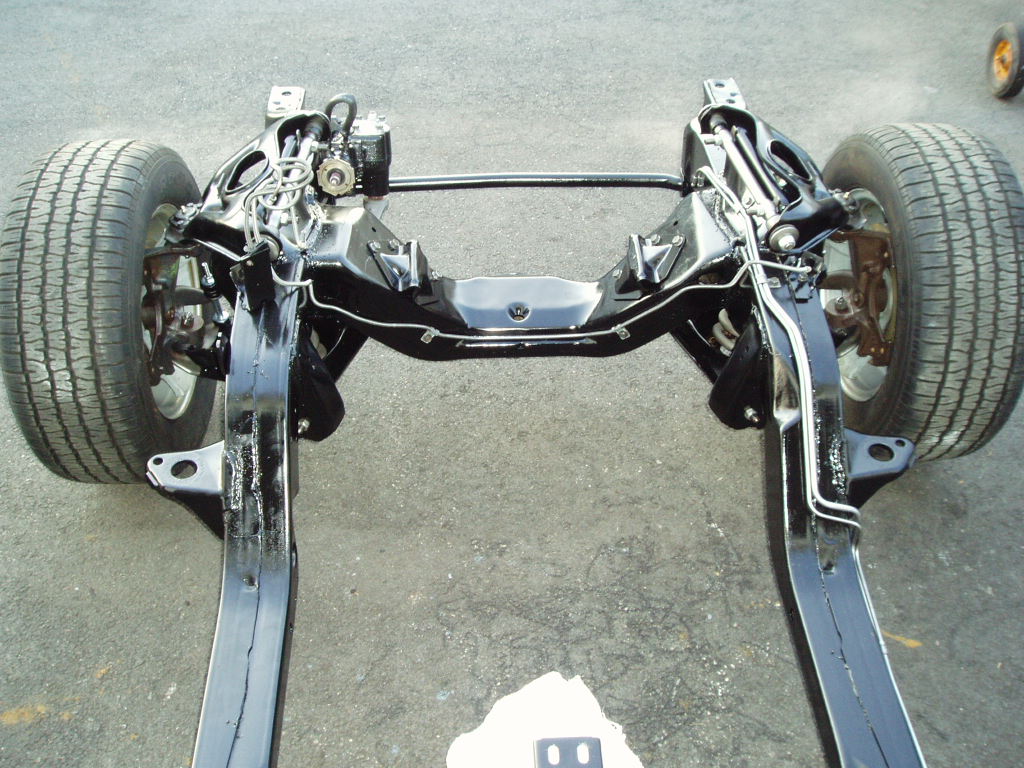

Here is the rolling subframe.
