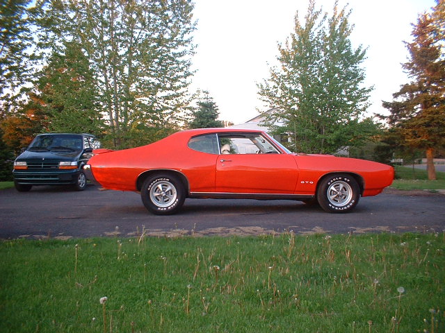

Here's a photo of my GTO taken a few weeks ago when she had her engine in her...
