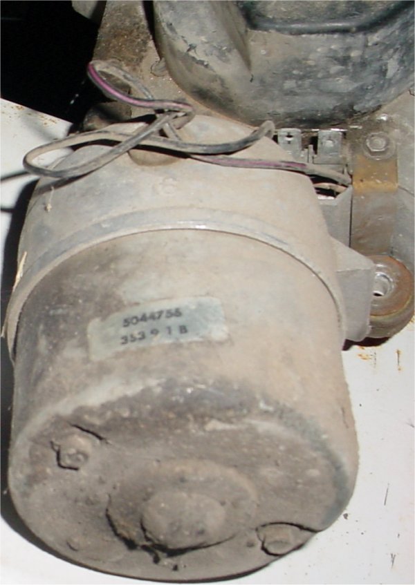

gto19, here is a picture. This code might be considered correct for a 1970 02B car, as it is on my 02A car.

how would you read that?
damn i wish i had your knowledge!
thanks alot dude

Top line, number is the part number. Second line, first set of numbers is the day code (353th (Dec. 19), in this case) second number is the year (1969, in this case). The rest are probably shift designations and such.

i looked at mine and it has this.its also a silverish color.
258 9 2a
my car is 70 goat
10-c-69
